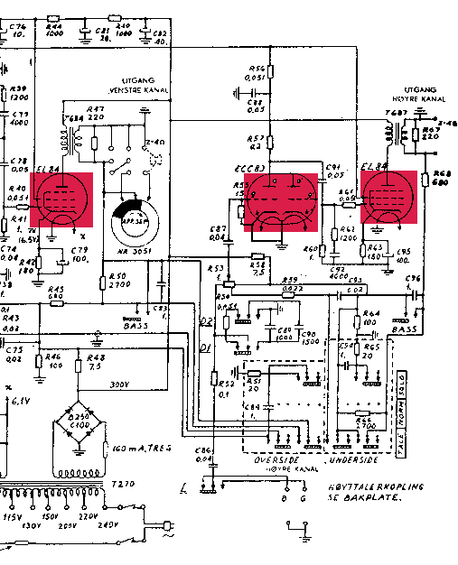

The output tubes may have low emission due to their age.
I'd replace them with new tubes.
Is the volume control original? It may have been replaced with a higher value, causing the output level to be too low when the control is below the 50-60% position.
One more thing to check- if the volume control is not original, make sure that the replacement isn't a linear taper.
Wouldn't that have the opposite effect - i.e. too sensitive at lower settings?
Gday.
After looking at the schematic for it, it turns out that
it is one el84 pr.channel. (strange arrangement
if you look at the schematic and the signal out
is infact true stereo on one out.)
The "changing tube" thing i tried
and the diff, turned out to be "gas" = one faulty 84.
So wrong "pot/values" seems more to be the case.
btw: Am attach the amp. part of the radio.
It seems like in time, the pot is wired to one.
(i like it like this, but i assume it`s then to small values,
1 mono pot. wired for stereo.)
(on the shematic each channel have there own volume)
I reckon he have done the same with the out`s.
ps. if you miss anything from the pic. give a shout.
