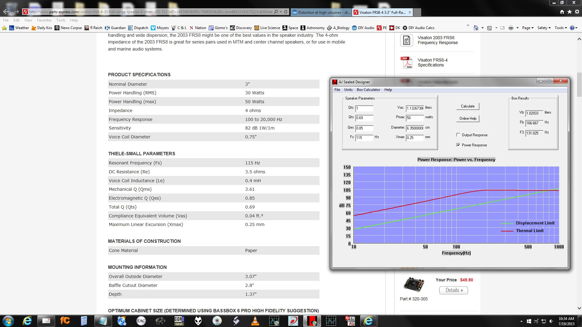

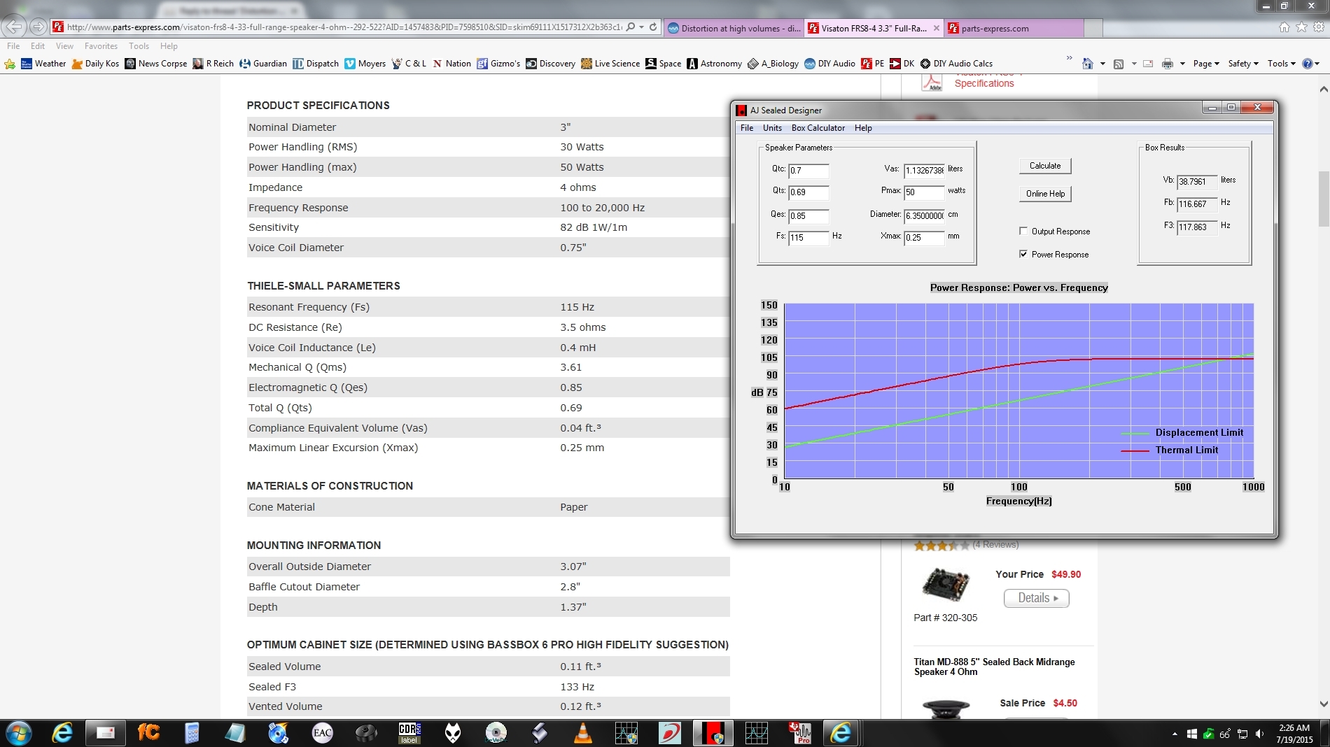

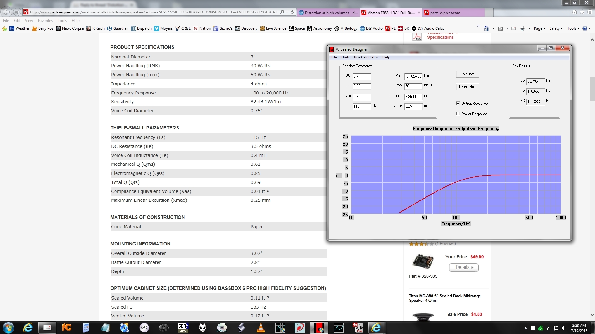

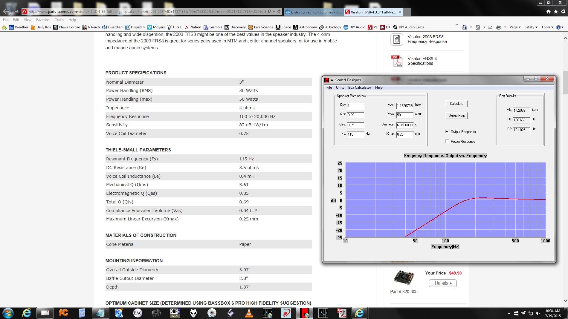

OK, first, I'll address your final comments;
Sadly, you DO need to change your whole setup if you expect to have a system give you full range sound at high output levels, the underlying physics will always prevail. Trying to avoid these responses will get you nowhere.Ps, I know this is weird, but I don't want to get into off topic conversations about why this is such a bad setup in the first place and how I should change my whole design. (Trying to avoid those responses) Any help is appreciated.
As I stated earlier, that Visaton driver is not really a legitimate full ranger and the graphics below show you why it's not.
The first two are with the driver in a box sized to give flattest frequency response. Number two shows the basic problem. The thermal limit sets maximum SPL is down to about 102 dB at any frequency, it's displacement limit is on a steady downward slope, and where it crosses the thermal limit at 900 Hz is where the distortion begins to rise, at 100 Hz it's SPL down to about 65 dB. The next two graphics show the driver in a smaller box giving a two dB hump around 250 Hz which will give it a "boxy" sound.
So your only options are to put it into a horn enclosure as others have said, or get a physically larger driver capable of higher output and with higher sensitivity ( at least 87 dB 1W/1M or higher) and live with the inevitable limited high frequency response, or move on to a multi-way system.
You would also benefit from a higher power amp.
Sometimes the truth hurts, but reality is what it is.
Mike
