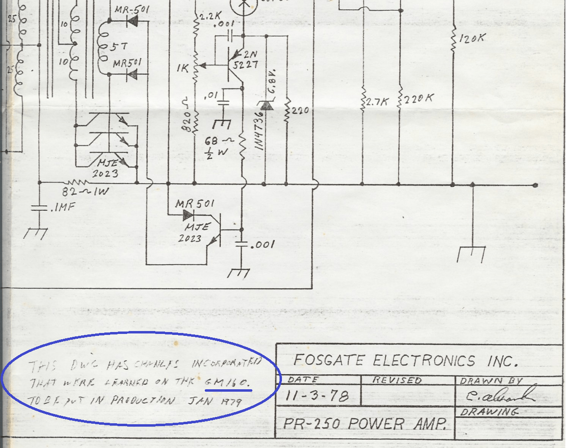

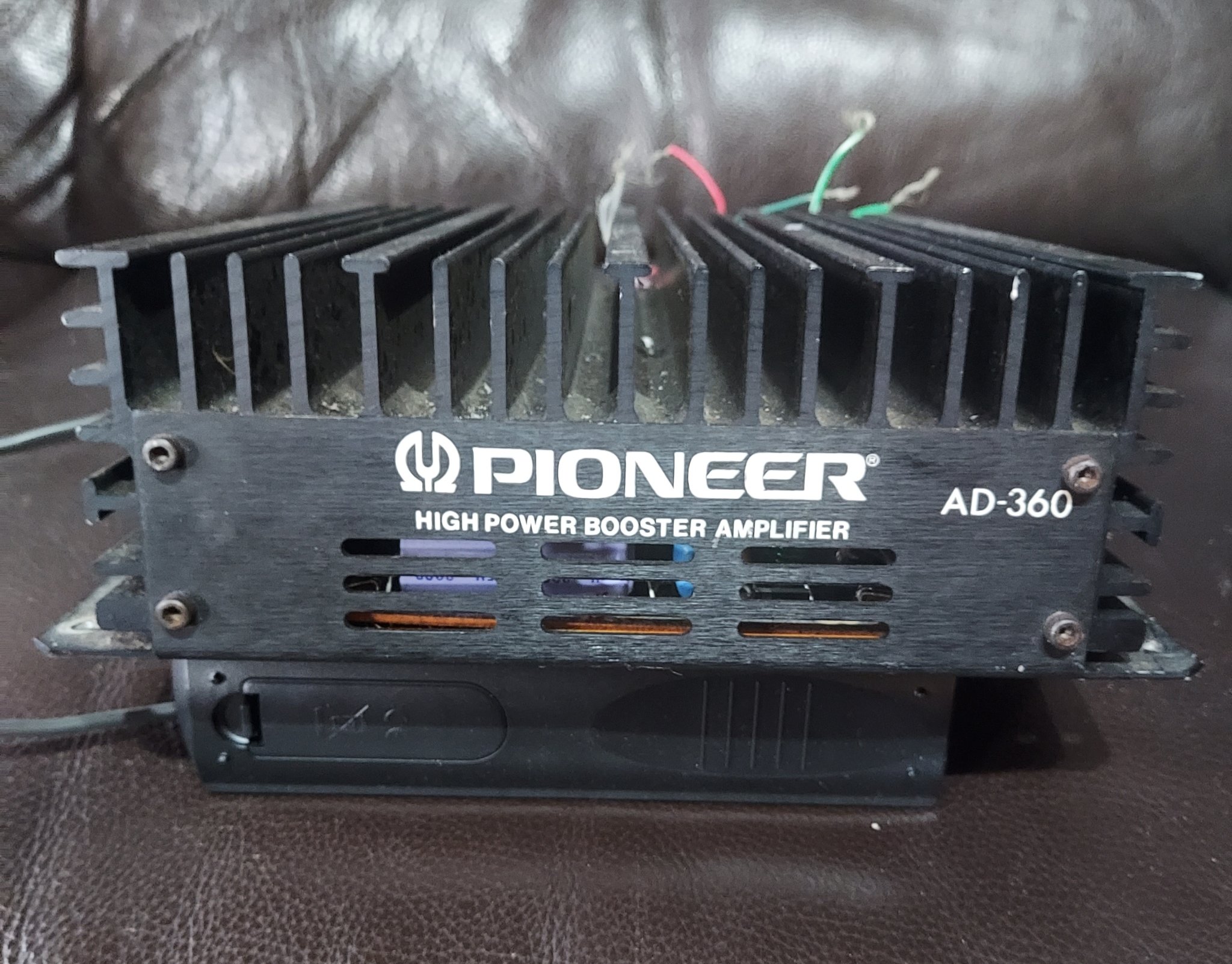

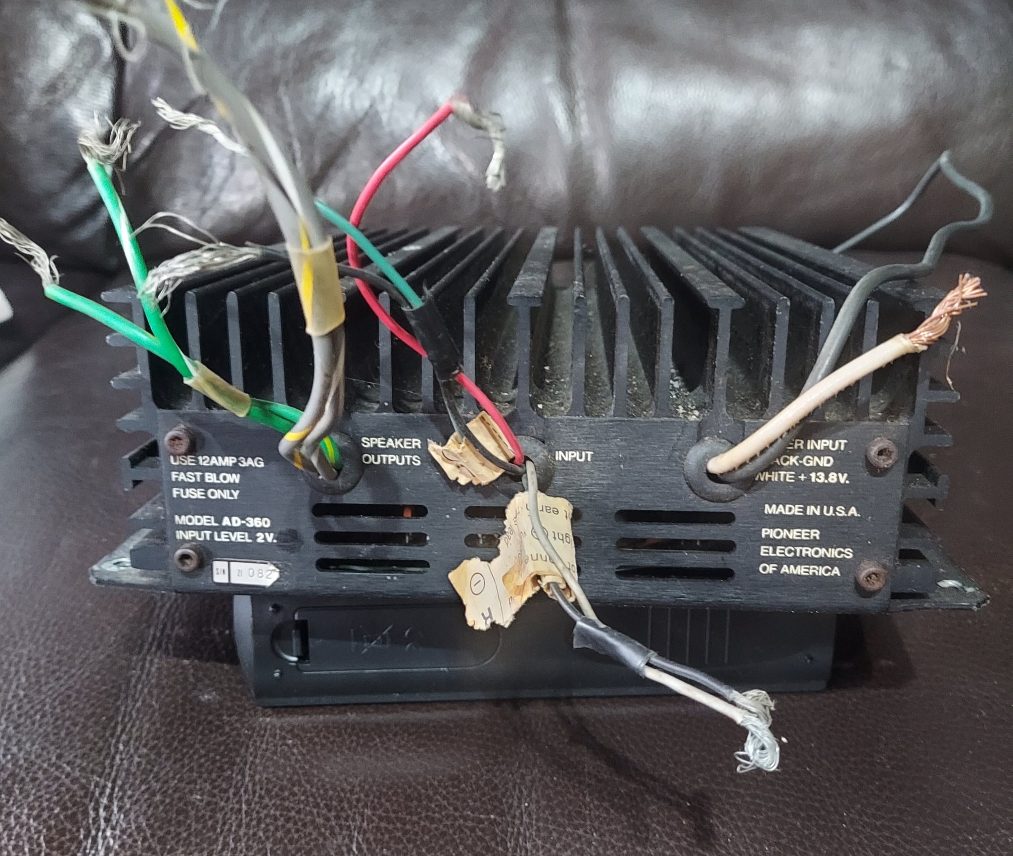

I recently acquired a Pioneer AD-360 from the late Jim Fosgates estate. At first, I was hopeful that he threw some secret sauce in this one and i'd get to be the only one to enjoy that. Turns out he didn't. In fact, it didn't even work. So my next guess was a friend left it with him for repair because 'My buddy Jim knows amps' is probably how the rationale went.
So I went looking for a schematic. But I was too cheap to buy the service manual. Then I started looking up part numbers. The part numbers led to a thread here
The drawing note on the PR-250 schematic led me down a rabbit hole as not only was I able to use the PR-250 schematic to service my amp, it bears the 'GM160' stamp!
The drawing note:

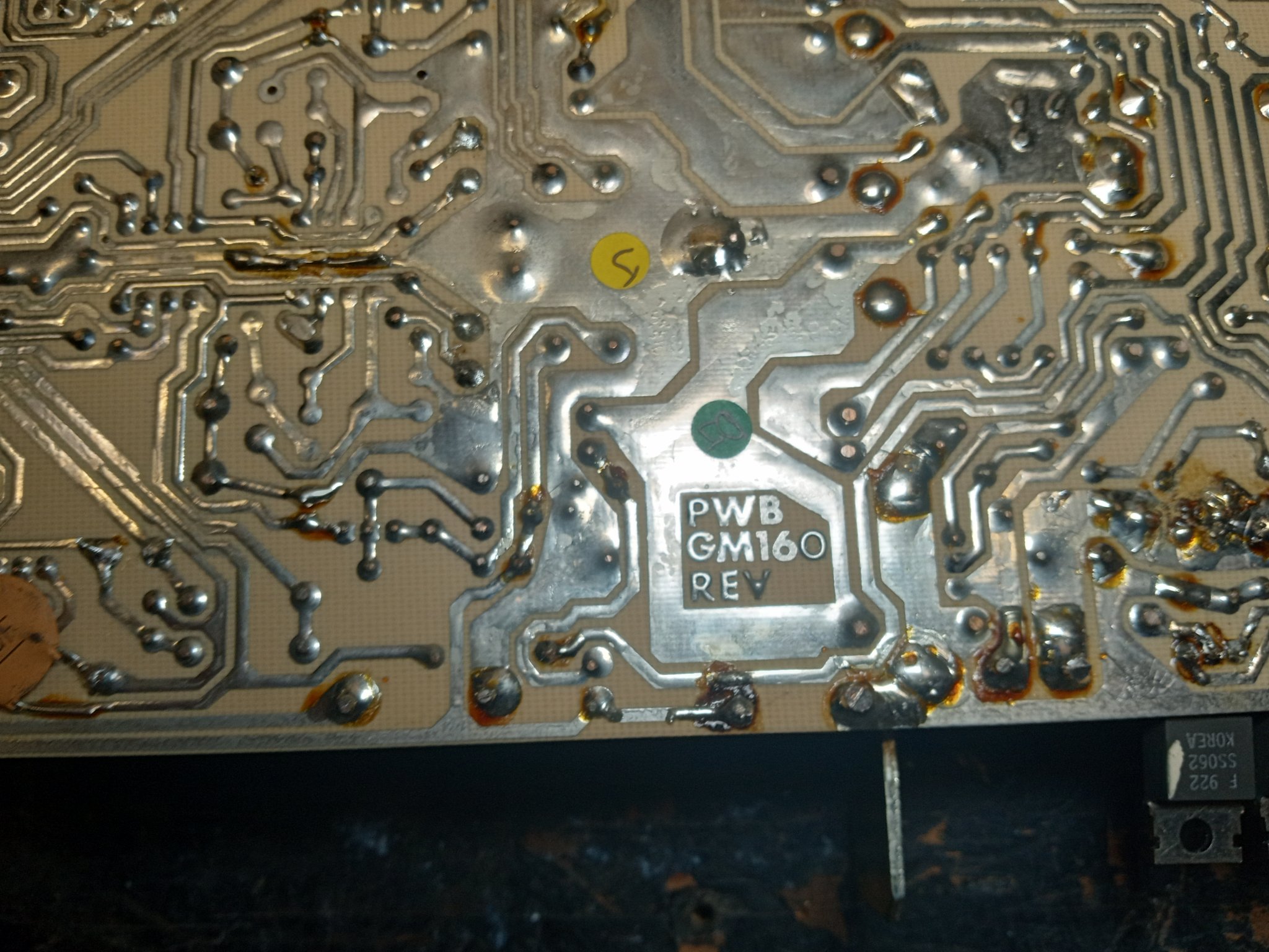

The board stamp on my AD-360:
At this point i'm just MADE of questions. Both of these amplifiers were released around the same time. It's sitting in Jim's house. One board is referenced in another's drawing. They're both 'Made in the USA' which is not common for Pioneer electronics of the era.
What was the relationship between Jim Fosgate and this product?

I recall long ago the story that went sorta like... the Brand NEW Company, PIONEER of AMERICA was founded and soon thereafter they introduced the entire line of new Pioneer products into the American market, Craig/Pioneer dissolved and Craig became it's own entity. Lots of GROWTH in the Autosound world in 77'... By 78 Pioneer needed an amplifier offering that could compare with the American High Powered offerings available at the time and it was decided that Fosgate Electronics would build an amplifier under the PIONEER brand name. I believe the GM-160 labeling on the PCB was later used for the GM-120 etc. Not exactly a big seller but an entry into the market it became. PIONEER still to this day building great autosound products. Left CRAIG in the dust, thats for sure. I Sold LOTS of Craig at Muntz and Pioneer at AA Sound Systems here in Honolulu Hawaii. LONG ago... I have a AD-360 here right now all taken apart and it had really bad capacitor issues. Cap read RESISTOR on my tester. Real bad. I swapped out all electrolytics and now its showing signs of life... well... No popping or crackling noises from the speakers so seems the power source went from switching OFF and ON to now, it stays ON... blinking stopped and the BULB is dark, low current pull now when ON. I use a Test Light probe to do the current sense. WAITING now for the Service Manual for this thing. Theres a CHIP, FE133-7931, its an 8 pin chip... op amp?... Cant find anything online so thats kinda where i am at this juncture. Will see how this one goes. It's TIME for me to start repairing my FOSGATE gear it appears. Ugggggg....... Will keep in touch here with progress reports and cries for help.... BDBD/2023.

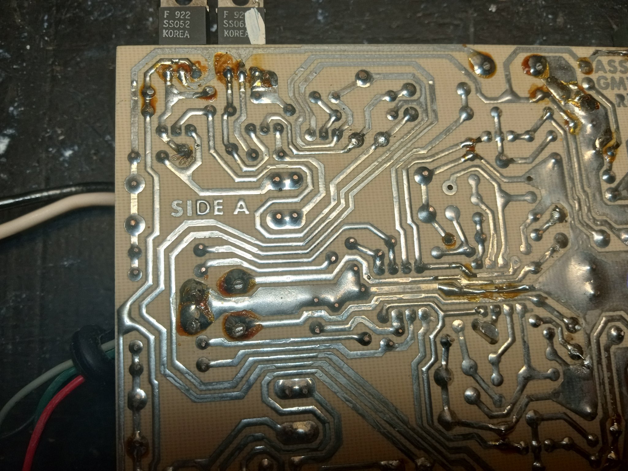

My AD-360 PCB is a tan color, not green like in the image above. Looks like a OLD Fosgate PCB, certain features are present but others not. I will take some pictures for comparison sake. BDBD/2023
