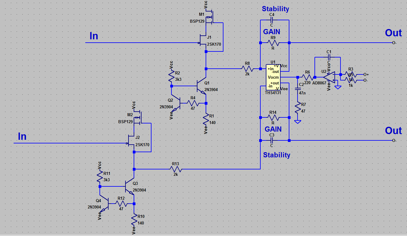

I'm basically looking for a discrete unity gain differential amplifier topology (for converting a balanced signal into a single ended one - inputs need to be high impedance!). Has anyone dealt with a similar problem before?
Backstory:
I'm making a front-end for a combo mic/line/instrument input that gets fed into an ADC. Low-noise op-amps/instrumentation amps (<2.2nv √Hz) tend to be quite pricey, so I thought why not chuck my own together with 2N4403/2N4401's that I can get for a couple of cents each.
The solution I've come up with so far is basically 4 discrete op-amps, with 3 of them forming a unity gain instrumentation amplifier, with the last one performing up to +60dB of gain.
Why 4 op-amps and not 3 you ask, as in the case of an instrumentation amplifier? I'm using a digital potentiometer to control gain, and in order to avoid wiper distortion due to dynamic resistance, I've configured the last op-amp as a non-inverting gain stage. The wiper is connecting directly to the inverting input, which has something like 10+ meg ohms of resistance, so *fingers crossed*, the current through the wiper will only vary by a couple of uA.
It seems like a huge waste to use 3 DOAs to achieve, what is essentially, a differential to single ended buffer.
JFET source followers with CCS loads --> your favorite single opamp differential amplifier. If you worry about matching, just use a single opamp (not a dual) that has offset trim pins and don't bother matching the JFETs.
LSK170A Nchannel JFETs are low noise devices, sold in the diyAudio store. Run them at plenty of mA of bias current and drive low impedance resistive loads.

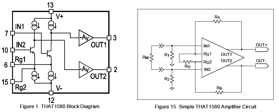

I've kind of given up on the unity gain differential buffer idea, and am essentially going to steal the THAT 1580/1583 architecture, but in discrete form. Their way of dealing with the digipot problem is to vary the feedback resistors with 2x digipots, instead of the Rg (gain) resistor. I thought this might reduce CMRR due to poor digipot matching... However, a useful property (that I completely forgout about) of the typical 3 op-amp instrumentation amplifier is that identical input signals are always reduced to unity gain from the gain stage, no matter the feedback resistor ratio. This means that the following difference amplifier is able to reject it at its full CMRR.
The THAT 1580/1583 architecture is also kind of unique, since it doesn't use a differential input stage. It instead uses a single input transistor with an inverting gain stage and current feedback. This necessitates the use of a blocking cap + DC servo, but I think the trade-offs for manufacturability + noise are worth it. You no longer need a matched input pair, plus the noise for a single transistor is 3dB lower than a differential pair (plus I already prefer a blocking cap to remove external DC offsets anyway).
I think I'm going to use a JFET as the input stage, since with instrument inputs the noise current from BJTs will make the noise figure pretty horrible. I do wonder if the open loop gain will be reduced/distortion will be increased in place of a BJT though. I'm thinking of using something like a 2SK880 or equivalent JFET - the noise should be under 2 nV/sqrt(Hz). I also want to test a bunch of other JFETs as well that don't have published noise figures. Ideally, I want to plug line/instrument/microphone/whatever into this thing and just have it work as a universal front end with a low noise figure.
In any case, it's annoying that one of the better (and commercial) solutions to this problem is "just use more digipots".
...The THAT 1580/1583 architecture is also kind of unique, since it doesn't use a differential input stage. It instead uses a single input transistor with an inverting gain stage and current feedback....
That's not how I see it. Input pair with differential NFB to both emitters. This was normally followed by a 4-R diff-amp; I see THAT proposes another path using their 5171 part.
