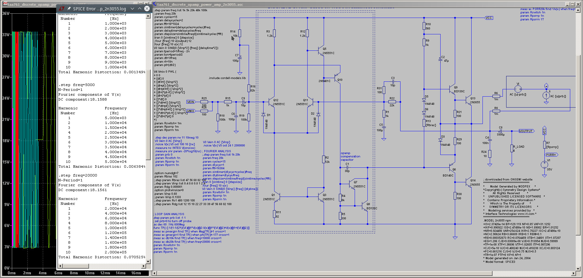

I always wondered how one of my first amplifier builds based on TAA761A/2N3055 quasi complementary amplifier performed, which I have build around 1979/80.
The original schematic is lost - I have redrawn this as good as I could remember. The original design was powered from a single 35V regulated power supply with integrated overcurrent shutdown. The amplifier survived every disco party at that time - only one treble speakers has gone forever ...
The TAA761 +input was biased to 1/2 of 35V and the speaker was connected via a 2200µF capacitor to ground.
Using discrete parts the power supply isn't as critical as using the original TAA761A which was limited to max. 36V.
The TAA761A has had a slew rate around 9Vµs.
Attached a simulation just4fun. Shown schematic is completely untested!
BR, Toni
Fix errata: titel power is wrong! Output power is about 25 - 30W@4R

Interesting beast, this young whippersnapper never heard of that IC. I would presume the transistors in the TAA761 have more to do with BC547 or the like than 2N5551, which are highish voltage types. An electrolytic across the bias network would seem worth a shot, and the Baxandall diode arguably better be something a little beefier than 1N4148. Actually going with much beefier diodes in the bias might just enabling going with three of 'em. Experimenting with external impedances also seems worth a shot, I very much doubt the input pair is balanced particularly well.
C5 should have positive end to ground.
I slipped up on that when I made my first quasi.
Because the output drivers aren't symmetrical there is a negative voltage fed back to the ltp on no AC signal.
Q6 will probably need 100pf from base to collector to stop oscillation.
You might also find you need 10R base stoppers on the 2n3055.

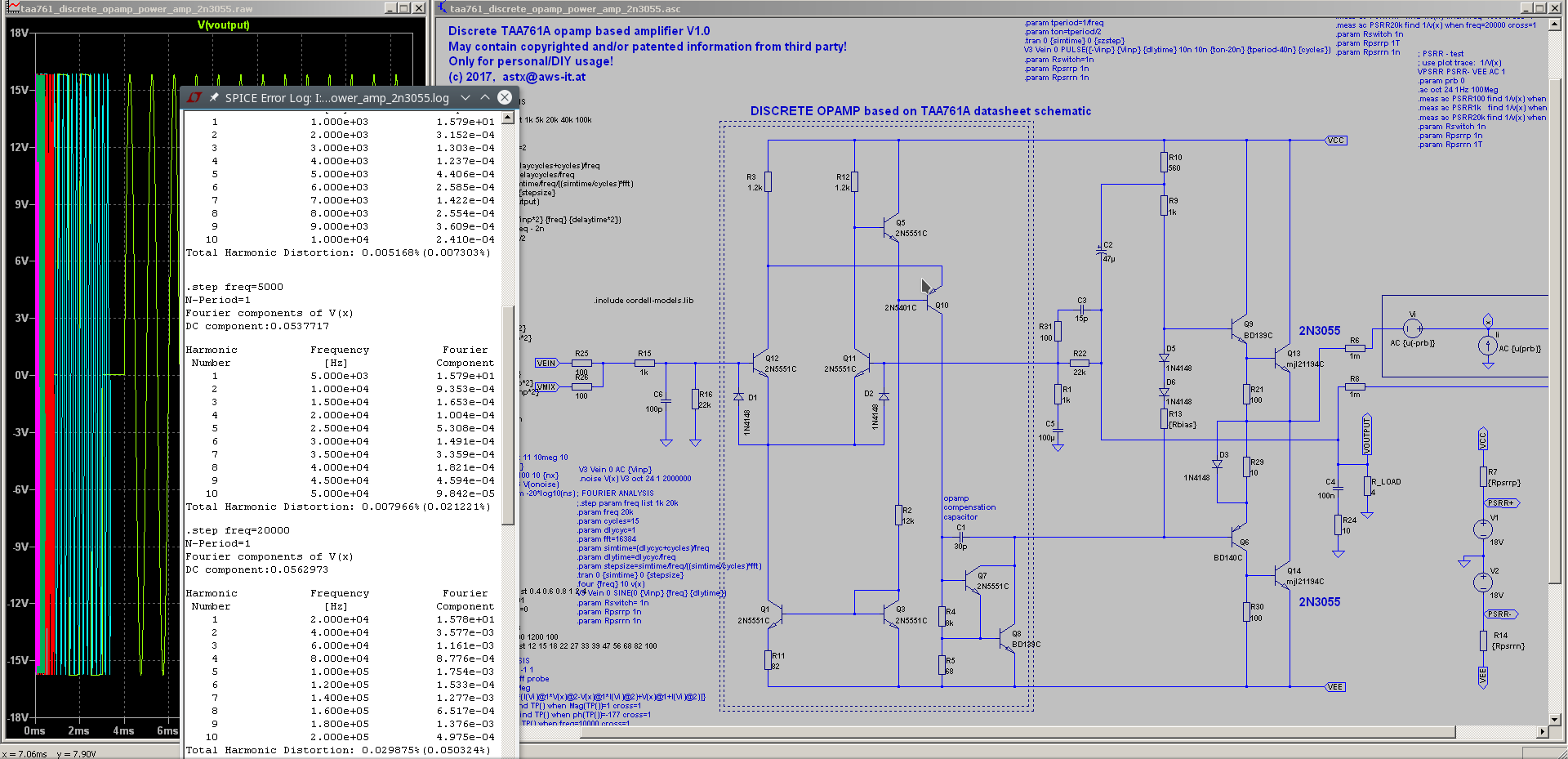

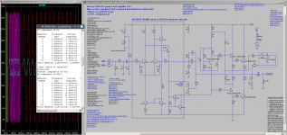

Now with TMC compensation. Better bias circuit. 100mA OPS bias.

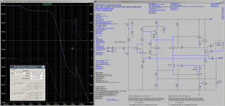

Discrete TAA761A opamp slew rate like datasheet (~10V/µs).
Seems stable. Who want to breadboard test it? 😉
BR, Toni

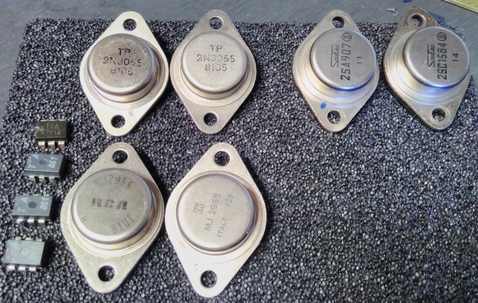

This smells like fun ...I still might have some of these open collector TAA761's laying in my drawers...
Best regards!
Only found one TAA761A - looks like it could be defect...
The TAA861 only withstand max. 20V but may be good enough for a test.
Don't know from where I got the TAA861...
Found some vintage MJ2955 and some Sanken complementary power transistors too...
Does anybody know the vendor TP / 2N3055 (text "MEXICO" on pin side)?
BR, Toni

Be cautious! TAA761 and TAA861 are pin compatible, BUT only TAA761 features the open collector output that is needed here.
Best regards!
Best regards!
Interesting... datasheets show same internal schematic. both need RL from pos. supply to output...
