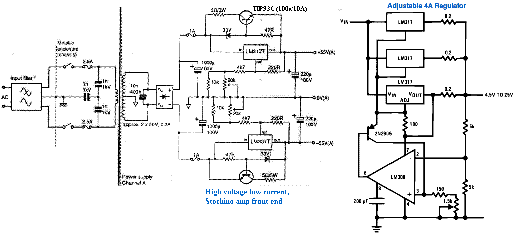

LM317 is acceptable and is very useful. It is not as quiet as LM78XX but it doesn't kill the dynamics. If better regulation is needed, then add a good discrete regulator after the LM317 (shunt one). I sometimes use 2 equivalent LM317 regulators in series. For higher voltage than 25V, add another high power transistor. For higher current than 1.5A, you can parallel LM317s.

LM317s can be 'stacked' onto one or more zener diodes as well, the current through the zeners is that of the LM317 sense current through the voltage programming resistors. Each zener needs a decoupling cap. This allows you to reach higher regulated voltages. If you're going above aproximately 30V, you can add a 33V zener between the input and output of the LM317. This ensures that it will never see more than 33V during startup. An 1.3W zener could handle the charge spike of the small decoupling caps used in the fed circuit. It works well if you only feed the driver stage and give the output stage of a power amp its own supply.

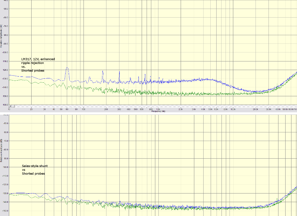

For sensitive circuits, or circuits with limited PSRR, I vote for the Salas shunt:
http://www.diyaudio.com/forums/atta...-dc-power-supplies-fft-shunt-power-supply.png

I'm ever measured the ripple voltage and noise from LM317, and this one Finesse Voltage Regulator Noise! can help improve it.

lm317 type regs can handle MUCH higher voltage than 30v, what they cant handle is more than 30v input to output voltage differential. you can have 200v input and 190v output without any problem. i use them at 50v daily and they hardly get warm. if you can spring for the LT version its considerably better and the lt1085/1033 an even better drop in replacement.
