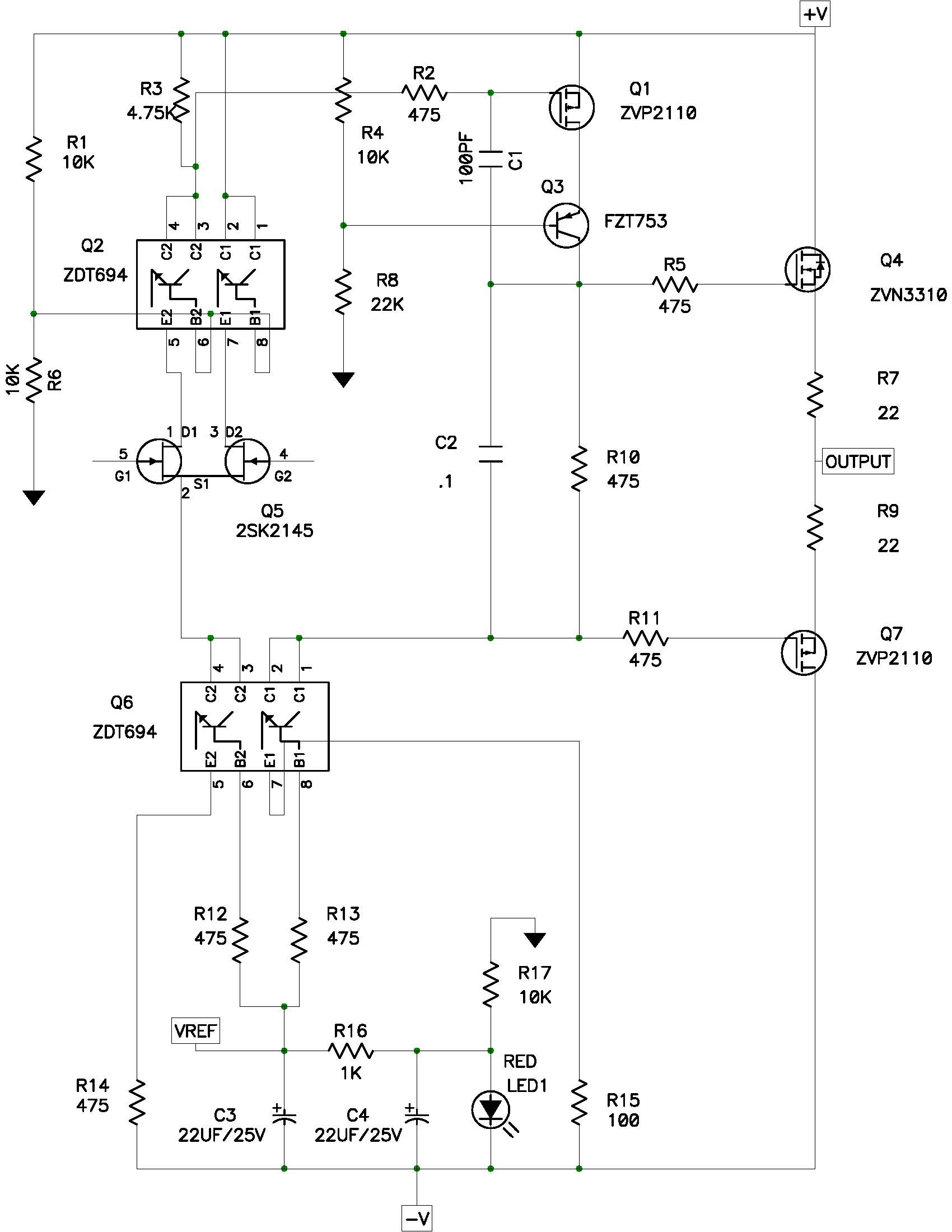

goals/target applications?
a good MC phono pre /= decent condensor mic capsule buffer
improving SOTA requires knowing what it is, where the theoretical limits are

What performance do you require?
Input impedance, supply voltage, PSRR, CMRR, gain, current drive? Output stage class? Short circuit withstand?

What is the end goal? Got to define that first.
It seemed, from JC's thead, it was to be a better Jensen 990 using similar or OpAmp topology?
see JC thread -- goal: 627 performance in discrete design.
IMO cant require IC for dc servo in low gain apps and no large bulky coupling caps required to use this 627 goal equivalent.
OK, to get that here, from your post:
1) 8 transistors or less
2) drives 30 ohms with -105dB harmonics from 20Hz->20kHz
3) S/N -110dB (input shorted, 1Vrms output, unweighted)
4) no DC servo
5) DC offset on output less than 2mV under normal time/temp range
6) all of above with gain = 10 or less
Seems impossible to me but hey go for it. I got nothing.

Why not ?
My JFET DIP8 discrete opamp use 7. And it is 3 stage.
So we can do better.
http://www.diyaudio.com/forums/pass-labs/120445-pass-discrete-opamp-dip-8-package.html
No challenge, no fun.
Patrick

It must be competitive with what is out there already.
It is less of a challenge to do better with more.
[ I could allow cascoding to be considered as a single transistor if it cant be done otherwise. Current sources, diodes might not be counted]
BUT - Scott wanted to do a discrete version for audio of the 627 opamp and that is fine with me. I dont want to start doing something Scott did not say he wanted to do.
A discrete opamp circuit of 627 opamp would be nice for others to compare with the integrated version.
-RNM
