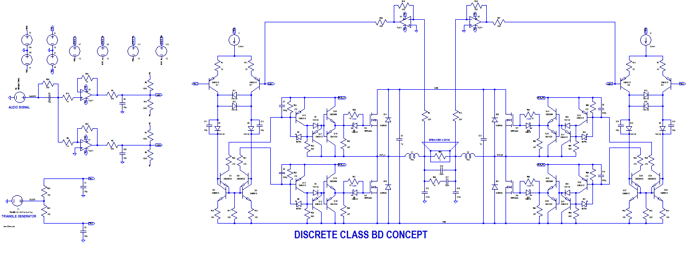

Simple circuit of class BD design can be achieved with discrete design.

I found a thread on this forum mentioning the class BD used by Rockford. There was no elaborate description of how class BD differs from a self-oscillating class D like the UCD. I see no lead network in the circuit.
Do you know the idea behind class BD? It is the first time I hear about it.
ÑBD modulation has each comparator for out A and B

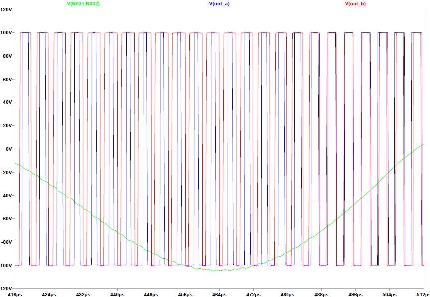

Please zoom plot voltage in second post. That is a specific switching result from a class BD.
As a result BD class only need half switching speed of other class D because ripple out A and B is cancel each other

I believe to have understood a concept:
The Class BD relates to a balanced input with two signal lines (a signal balancing circuit is shown to the left in the schematics) and BTL output configuration with two output lines. Each input signal is modulated separately with an individual comparator and controlling only one output. If a traditional clock-controlled modulator is used, the same triangle reference-signal is used for the two comparators such that switching of the output lines is synchronized but differ in switching moment. If the modulation is through a self-oscillating design, the two outputs may not be synchronous. Due to the two individual comparators, the switching moments of the two outputs are normally displaced such that the resulting switching frequency appears higher than if fully synchronous switching at the same moment is used. Thereby, the output filter becomes more efficient or the switching frequency can be reduced with the same effect of the output filter.
What confuses me a bit is discussions about “AD Vs BD modulation” where AD modulation is described as a two-level modulation and BD modulation as a three-level modulation.

From what kartino shows, this design is apparently a two-level design which the switching simulation confirms. Or, does temporary current recirculation at one of the rails count as a third level?
