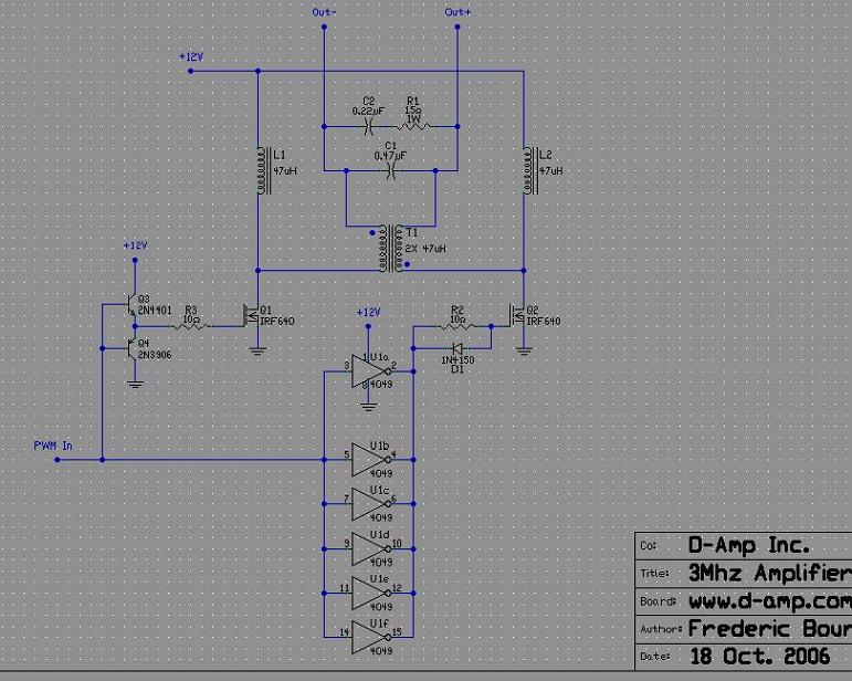

Here a pic of an idea I just have and try...5 watts RMS, but at 3Mhz switching frequency, open loop, with booth fet ground referenced...Drain signal is a bit poor, but sound quality seem incredible!

Just the idea to put 2 flyback convert out of phase to be able to drive mosfet on common source. It's exactly the same principle of dual forward DC converter, when one push, the other pull on freewheling...Nobody have seen that??? Drain voltage go over twice the supply with some garbage, but dont seem to affect sine wave..And dead time between 2 switch dont seem to have effect too... I can push it to 3 mhz before to feel the output get warm. Sorry if I dissapoint you guy, but that was an idea and I have try it. Dont know if I can got ''bigger result'', but idea work on breadboard with cheap components...And work on first try without any calcul...I use a LM361 to drive the CMOS and first drivers with a 5-12V level shifter...Really simple!

A 3 Mhz switching frequency imposes a 333ns period, which means that every half cycle lasts for 166ns when the amplifier is idle. In order to achieve class D operation, each MOSFET must be fully turned on and then fully turned off within that 166ns period, and each switching event should last for a very small time in comparison with the main switching period.
Now, how much do you think that a IRF640 takes to turn on and turn off with a 10 ohm gate resistor and considering the high and non-linear typical MOSFET output capacitance in the Vds<25V range?
What a nice linear amplifier you have built, indeed (the filtering is done at MOSFET gates). Next time take the dust out of one of your oscilloscopes (assuming you own one capable of showing a 3Mhz square wave without too much "edge rounding"

A circuit producing some sound, even at high powers, does not neccessarily have to be working properly or as expected.
BTW: And yes, you have discovered linear amplification 😀

Read post EVA...Mosfet begin to warm at 3Mhz....I saw that drain wave form was sine at that freq...I'm not stupid! 🙂 Yes it play sine wave and music, but in PWM, not linear...Just wish to find the camera in box to show you pick...Thank's to think that I'm beginer!

Hi Fredos,
I'm afraid you only get an output signal thanks to the imperfections of the real components:
The average voltage at the drains of both FETs must be 0; the waveform might be widely assymetrical, but it doesn't matter: the volt-second product across a perfect inductor has to be 0 over a period of time, otherwise the current will climb indefinetely.
Your inductors have some series resistance, which allow some AF signal to leak through; with better inductors you'd get nothing.

Eva, you didn't account for the variation in delay imposed by the different gate drivers ?? I expected some third harmonic generation out of that

I had similar idea few months ago, but frequency was not that high and without feedback loop it is useless.
Wrong, it is actually a resonant converter, so it "works" in a way.

Drive it with LM361, but like I told, square was like a sine wave a these frequency, and resolution go out rapidly. I just told that I push it to 3 mhz before output get warm! Optimal setting was near 700Khz and under. Have try to close loop, but don't able to make it stable...Anyways, was just the try of an idea...And sorry for all others that think this is a linear converter or space communication device...🙂

This circuit is flawed from a theoretical perspective: it simply cannot work. L1 and L2 should be made large enough to present a high impedance in the audio band; it would then become a "double single-ended class A/D amplifier". A real mess, yet it could work; but with proper 47µH's, no way: the outputs have to stay at a 12V average. Any output voltage is caused by the parasitic series impedance of the coils. You cannot rely solely on parasitics to make a circuit work.

Bit hard over internet! And is only about 5W RMS with 12V supply, even with 0-100% modulation....The 47uH coil cannot provide more voltage swing and lower or higger value give bad result...That's just experimentation...And I go to saw the US patent...I'm not the first to try that!
