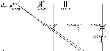

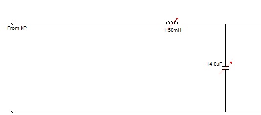

I had designed a custom crossover for my sound box of single 12in speaker and a 2in tweeter.
When the sound is playing at low levels it is sounding perfectly balanced, when i increase the levels of the music played the mid high balance is completely lost.
What should i do to maintain the tonal balance even at high levels.
It is a 12db network for the speaker and a 24db network for the tweeter.

OK, you have a 6 to 7dB difference in sensitivity between the woofer and tweeter, what are you using to balance that?
I have the DE750 with a pair of 15" drivers and the speakers maintain very good balance up to power levels well beyond what you have but my system is actively powered and processed.
That LF driver's got some peaking around 2-3k, at least according to the FR plot on the website. If the inductor is sarurating this peaking may come through. Depends where the nastiness is. If this peaking is from cone breakup it could certainly get worse ar high power levels. If the nastiness is above 3KHz then both of these theories are out the window.
I am using a attenuator in the input side of the highs circuit to suppress the diffrence of the highs and the mids.
Even Attached the circuit for your reference
