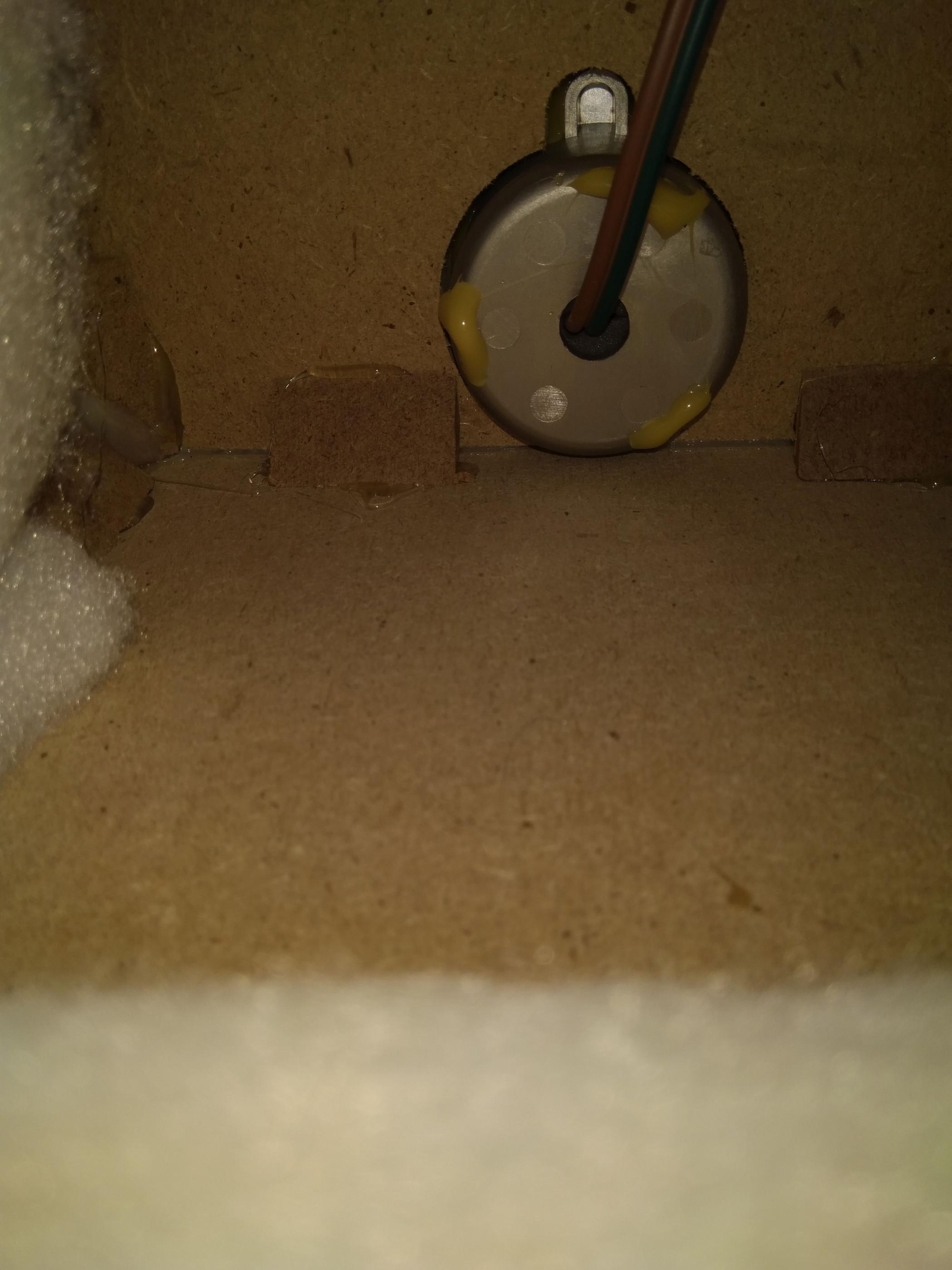

Can’t see a crew anywhere on that. Thought it was in the boss at the top but expanding the picture just shows a plane surface, but looks like lots of glue so may be glued in only.
At a guess the special tool may be a split tube that fits around the wires and into the central hole to push the tweeter through the front, just a thought? As the tweeter is dead then you could try this with a suitably sized Philips screwdriver I guess but don’t blame me if it goes all wrong. An alternative is that there looks like there are two small notches on the front that you could get a tool in to pull the tweeter out from the front, thus may be more plausible.
There is a picture on here of the tweeter and mounting, looks like you will need a direct replacement as it looks like it is designed specifically for the mount. And confirms that it looks like the tweeter is pushed in from the front I think.

Yeah ... wondering how to get the alu L shaped part fitting the tweeter from the box ... There was an other thread (Can anyone help me with this tweeter removal? Focal Chorus 836V) apparently on a very similar model. But not sure how the guy managed ...
If you have an old credit/store card you could try making something to go in the indents on the front and lowly work side to side (or make two). Think if it is plastic it should reduce damage to the front plate. Or if you have those tools for opening phones/laptops etc, they may work, or as I said push out front the rear where the wires come through.
