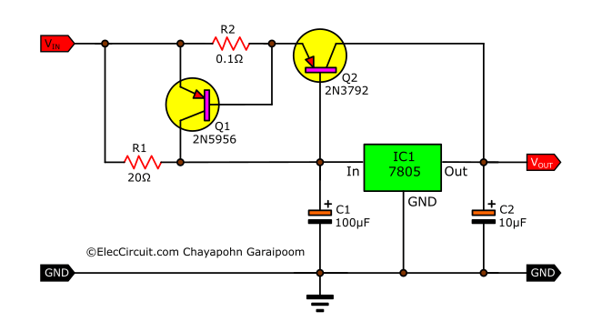

Disadvantages of using L78XX/L79XX with current boost(MJ2955/2N3055)
Wondering why the use of L78XX/L79XX with current boost(MJ2955/2N3055) is not popular as a simple linear regulator for chip amps and such?
Circuits like this (showing positive rail)
What are the reasons to shun these? Bad line/load regulation? Efficiency? For example a 15-0-15 200VA with the above configuration can make a good +/-18 V 5A power supply in theory.
I understand Opamp based finer designs with precise reference voltages have better line and load regulation. Is that the only reason?

And I am not sure how your example in your post gets from 12Vin to 15Vout (presume its a typo)
You need a 15V regulator for that

Because they are very noisy and quite slow (cannot respond adequately to a fast transient current change). The new generations of TO220 regs from LT et al are much faster, quieter and many are designed to be paralleled simply for higher output currents.
That circuit is just a reference on topology please ignore the values shown in the circuit. Actual circuit will be with double rails and 7918 and 2N3055 on the negative rail.
15-0-15 center tapped transformer can do this as a +/- Vin as after rectification the Vdc will be around 21v.

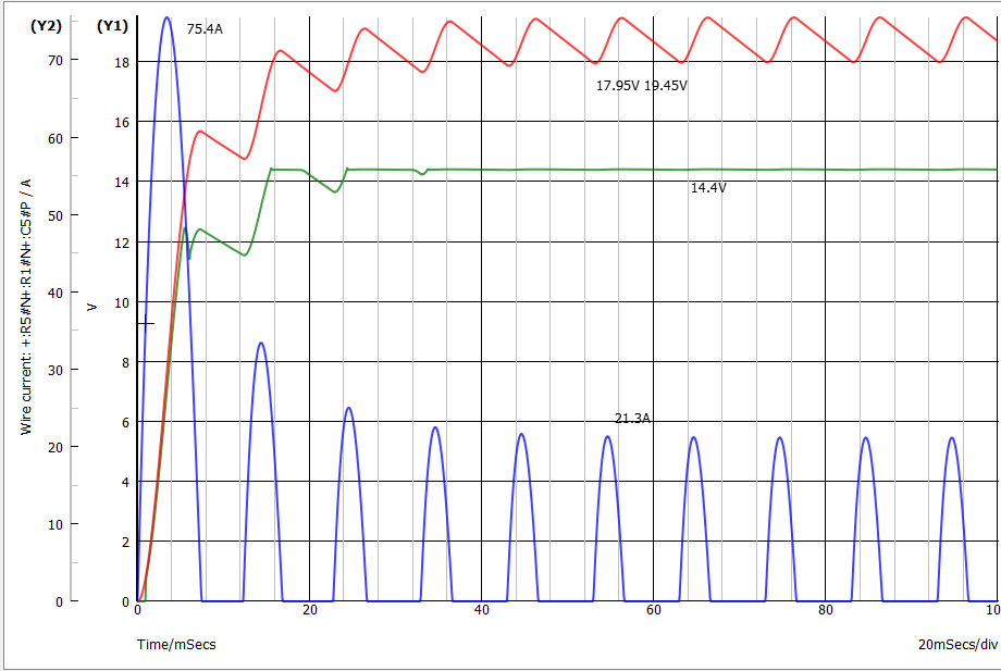

To come back to the original question:
I simulated the circuit. Used 10A Schottky and a 22000uF reservoir.
Red Capacitor Blu current Grn output
Unfortunately the outdated semiconductors do not do well even 15V can not be reached. The 2N2955 needs Veb= -1.29V the regulator saturates at 1.68V and the 100m ohm another 0.5V with 5A load current
when the output has more than 1uF load it starts oscillating, but with 10000uF is stable again.
Used a LM317 to have adjustable output.
