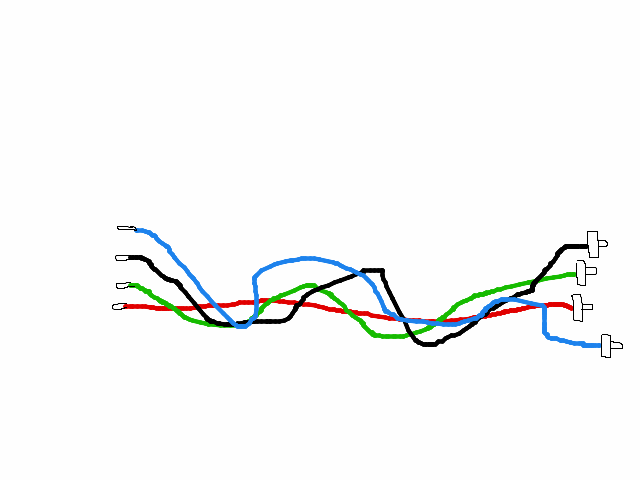

One problem with the tonearm is that it seems it have been badly rewired (probably the last owner broke the wire and did a bad and ugly solderjob on it).
So i have been thinking about re-wiring it, and to put direct wire on it. So now to my question.
I have been thinking about putting Cardas 33awg from the pickup down to the end of the base under the deck. and from there i solder it to an RCA-cable. Now my question, what kind of RCA (that ain't to damn expensive) would you people recommend me to go from there to riia?

not Clearaudio specific, but....
buy yourself something like 5 ft of tone arm wire. It is often sold in either coloured lengths or a group of five wires. salvage your cartridge "tags" from tour existing wire. order a pair of decent quality male RCA ends.
  • solder the ends of the new wires to the ends of the old ones
  • gently pull the wires through the tone arm and out the bottom of the tonearm base
  • while leaving plenty of slack, solder the new or salvaged cartridge tags onto the end of the new cables
  • join the ground wire to the arm near the headshell/carttridge or the base of the tonearm
  • solder the RCAs to the new wire following the correct colour convention
  • pull the slack out of the cable so the ends nearest the cartridge has no or very little slack (some is good to allow easy cartridge installation).
that's it. If the wiring cannot easily be pulled without damaging them then the arm will have to be taken apart somewhat to aid in the rewire.
stew
not rude...
but I suggested a single piece from your pickup to the phono preamp. put tags on the cartridge end, and male RCA phono plugs on the other with no breaks in between. One less junction, 2 less solder joints, so the fewest possible to have. Many problems are with the RCA junctions.
In this case no need for an RCA cable to be soldered.
Now if asking about RCA interconnects or RCA phono plugs or RCA phono jacks please clarify.
I think by the time you're done, my first suggestion would still be the best based on cost, and performance.

this is what I suggested, please see diagram
and a really bad one at that.

the ground wire....
well I think what I would do as follows:
solder a short piece of wire to both ends of the complete cable shield, attach one end to the tonearm, the other attach to the phono preamp. That way anything you "pickup" from the arm will be taken to ground, while still shielding the signal wires from exterior RF noise. Pretty simple and easy. AFAIK, there is no need to run a seperate wire for the ground, unless using unshielded wires. I personally use unshielded wires in one length on any mods I do or when I make my own arms, and have never had an issue.

OK.
Let me try and expand a little. Try and create a star earth. This is what the incognito loom does. I am not sure why, but floating the screen and running a separate earth lead sounds better.
So to try and re explain.
Best place for the star earth is probably at the base of the arm.
Connect the cable shield to the star earth point.
Connect your separate earth wire to pre amp to this star point.
Connect any lead that may come from arm tube or carriage on linear tracker that is linked to the tube body to the star earth.
(This is because the bearings and their lubricants may actually break the earth made at the base and the tube then is not earthed, increasing cahances of noise and hum.
Hope this makes sense now.
Wrt to the RCA split at the end of the cardas 4 core + screen.
Trim about 2" of outer rubber insulation, trim the screen short (we are floating it this side).
Push some adhesive heatshrink over the cable, an inch will do nicely..
Now push some of the rubber insulation you removed from the arm end and this end over each pair of (red/green and white/blue) leaving 1/4 inch of wire exposed at the ends.
Pull the heatshrink over the t joint created where the 3 lots of rubber insulation meet. Shrink heatshrink. Solder on RCAs.
Fit earth lug or crocodile clip to you separate earth wire.
DONE!
PS: In a tubed "arm" the outer rubber and screen should be removed from the cardas 4 core + screen section that is to run in the tube and through the pivot (the arm tube is the screen) else the bearing will not move properly, never mind getting the stuff through.
