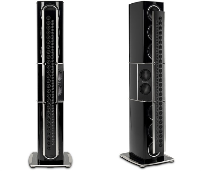

The McIntosh XRT2.1K loudspeaker standing at 7 feet, is a miniturized and improved Infinity IRS V .At 130,000 dollars it has solid theory behind it, whether or not the theory is backed up by real world performance is another matter as I have not received my review unit yet.
It offers upper mid range and high frequency directivity via 28 2" upper midrange drivers cut at 450Hz and 45 3/4" tweeters cut at 2.1kHz, these are oriented to couple in locally as TMT (tweeter midrange tweeter) and globally in a stereo setup as a compound MTM.This way the speakers deliver directly radiated upper midrange and tweeter frequencies allowing the speaker to decouple from the room, the array and a hardly noticeable hint of toe in ensures the walls are starved of the energy to sufficiently color the sound. The many drivers also ensure that each is only contributing a small amount of the overall performance, allowing the upper midrange and high frequencies to sound effortless.
The midbass or lower midrange is where most rooms have issues, McIntosh engineers cut this band at 150Hz to 450Hz making sure this speaker will perform well in most rooms, here the speaker is equalized for most rooms.There are two 6.5" midbass drivers that are physically toed in within each speaker. Locally these midbass drivers are put in a sealed section in a WMW (Woofer midbass woofer) configuration decoupling the midbasses from the room. The toe in couples globally in a stereo setup to create the global compound WMW decoupling the midbasses from the room.
The bass reflex brutes are placed towards the floor and towards the ceiling and cut at 150Hz, to give you an in room low frequency response of 12Hz, enough for goose bumps.These speakers do not need the support of a sub woofer, they are the sub woofer. There are 6 8" woofers, giving you a total of 96" in stereo setup, thats plenty of air being moved.

never read or heard about "decoupling the midbasses from the room"
well McIntosh don't claim that on their website . http://www.mcintoshlabs.com/us/Products/pages/ProductDetails.aspx?CatId=speakers&ProductId=XRT2.1K Not sure where the 'room decoupling' comes from.
It's a strange looking combination, mixing line array tweet/ high mid with those twisted mids...
twisted minds...
there is no acoustical benefit in toeing in (or out for that matter) of a 150<450 Hz speaker whatsoever
...except because ft the MT line obstructing on-axis and causing interferences in upper range and above xo. What type of xo?
In general I find these Steinway/Lyngdorf/McIntosh speakers strange and overdesigned and covered with heavy marketing mist. They might sound good anyway...

whatever, still there is NO acoustical benefit in toeing in (or out for that matter) of a 150<450 Hz speaker whatsoever, including "decoupling" understood as You proposed, it changes nothing

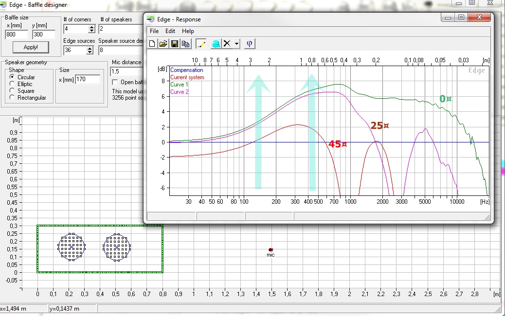

I try to help graaf,
- directivity of a loudspeaker(membrane) is dictated by
- membrane dimensions
- baffle dimensions
- frequency
Here is good presentation FUNDAMENTAL LIMITATIONS OF LOUDSPEAKER DIRECTIVITY — Audio Spotlight by Holosonics
Below certain dimension, radiation is omnidirectional (4pi), sound wave bends around baffle edge without creating diffractions. Main factor here is baffle width, the distance from the center of membrane to the nearest edge.
Above that frequency directivity is constant (but with baffle step) and 2pi until wavelength gets shorter than membrane width.
Above that directivity rapidly increases (directivity index increases) which means narrower radiation angle, usually we look at -6dB limit - eg. 90¤ means 45¤ left and right.
In case of the speaker in post #2, two 6.5" drivers are in a quite narrow box, passband 150-450Hz. Only the upper end is close to 2pi limit in vertical dimension, so there is only 2-4dB decrease in sound intensity to 45¤!

I just can't figure out what the designer has tried to achieve with those double 6.5" lower mids. Without those the bass line would have much more directivity vertically in that ranges. And usually floor and ceiling bounce happens around 200-300Hz, even lower with long listening distance and a high ceiling...
