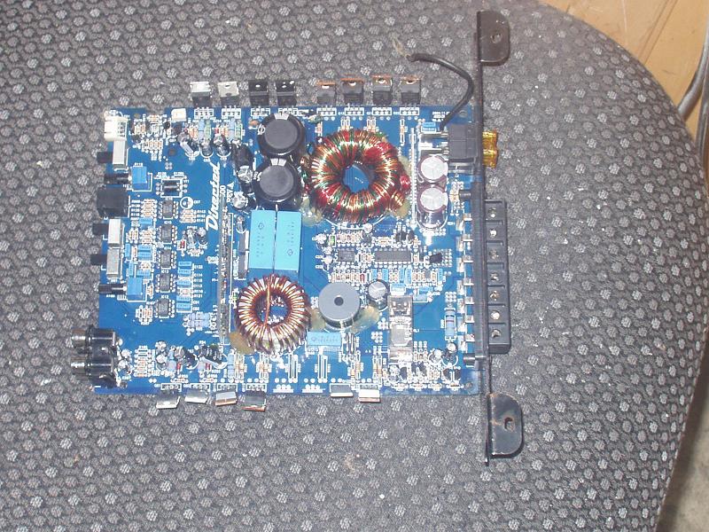

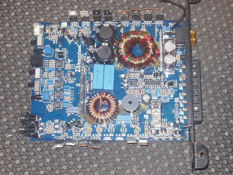

Im working on this amp when i recied the amp in for repair it was stuck in proctection mode I resoldered the rectifiers in it and checked all the outputs and power supply fets all tested good Now the amp wont power up at all Any ideas?
Pin 12 doesn't have any voltage. Follow the circuit for pin 12 back to the next transistor. It's likely open.
Ok got the amp to power up and produce audio but its very distorted.
I have both + - rail voltages at the outputs and have + - 15 on all opamps.
I replaced the switches and pots.
I have 0.93 volts across the emitter resistors Amps outputs is very distorted Any ideas?
