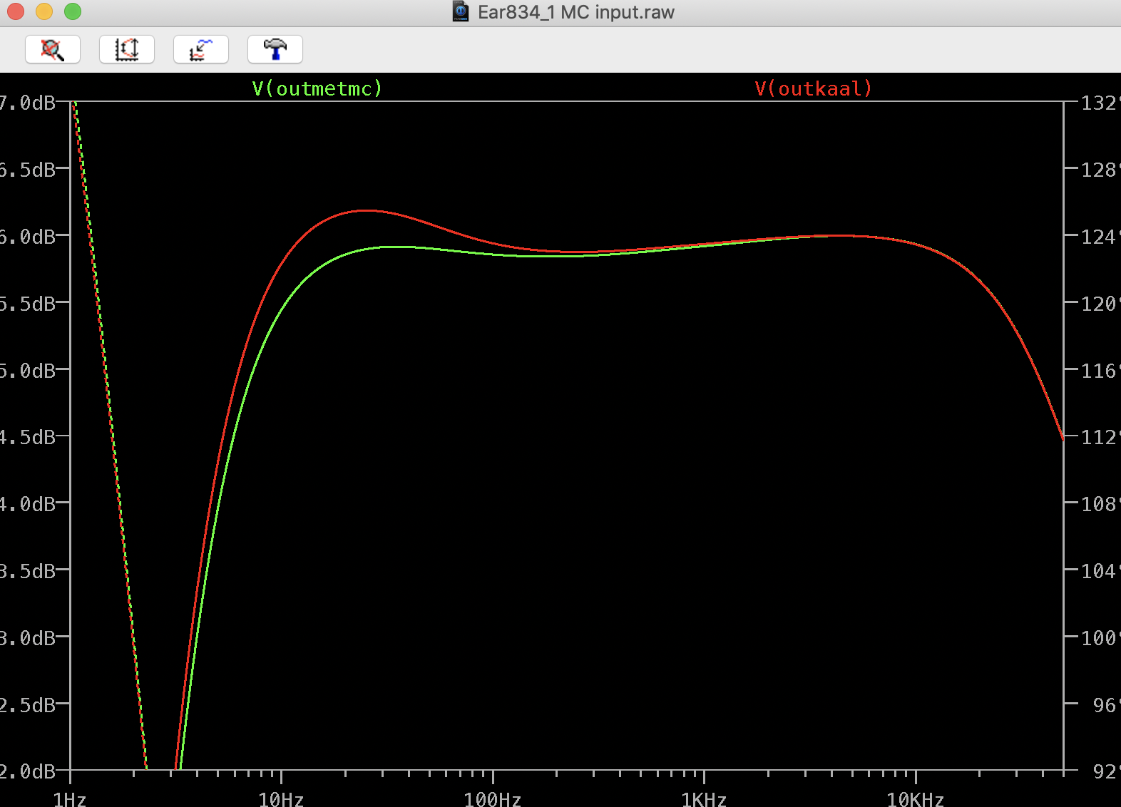

So, to present the conclusions:
Ith this simulatiuon output,
- red is the original circuit (this forum member Hans Polak's simulation)
- Green is the new design with the MC input
As you see, there is a slight difference that I hesistate to call an improvement (the small lift might give a slight impression of warmth).
As the jFET I have failed to use the 2SK170 (can't get the model to load) So I used another one but the working principle could be established. And that is my goal.
- The MC stage in the cathode lead can be connected without a capacitor and the ECC83 will 'float'.
- No effect on the Vak and Vbk, same working points
- NO effect on the internal resistance of the first stage ECC83 - most important issue as this is where the very short feedback circuit connects.
- Curve shows a reduced bump in the low bass (around 20 Hz), where the original cicuit has 0.2 dB lift.
- Due to the cathode coupling of the input, the high get frequencies have more breath in them. No MILLER capacitance in the first tube!
- The circuit is very sensitive to the precise power supply
- It still has the 6 dB extra correction of the EAR compared to the theoretical value;
- It is very easy to reduce the FET input amplification by 6 dB by reducing the Rdrain.

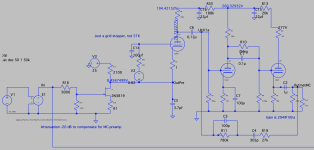

The circuit
Why chose a circuit with feedback?
The original TdP EAR834 circuit has and RIAA that has been tweaked a bit by the LencoHeaven guys (if i am correct, by amongst others, Loersch) to obtain a flatter response. I have take these "modern" revised components (the difference in the high frequencies is large, it is now >0.2 dB flatter).
As you see I have an extra power supply for the FET drain current: that is needed because the firtst ECC83 only conducts some 0,7 mA and that is not enough for the input FET. I need to get some extra juice somewhere else. I am considering other circuits too. But for now this suffices.
In the simulation, I have use a stock FET from LTSpice, I have yet to load the LSK386 I will use to the library (my attempts failed; I have a Mac and things work different here) but the principle of connecting the two "stages" as cascode is clear: Connect the cathode to the drain and have a separate drain resistor.

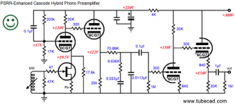

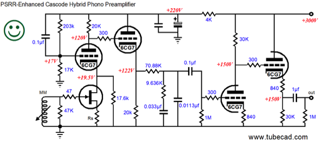

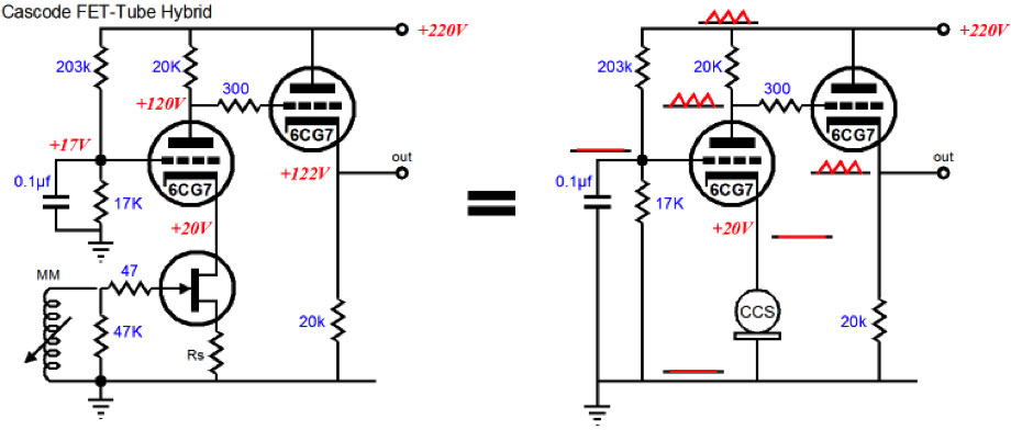

As a side note, Simulation guru John Broskie warns against the cascoding of FET input and the first tube, because the PSRR is virtually zero. He proposes a Loftin-White coupling. But that has a reduced amplification by some 25 dB. The only way to use it is having a LW coupling with a very large Rk and hence it starts to look like a gyrator. That is not of my liking. It means introducing a capacitor. In my circuit as I have used it since the eighties it is not needed.
About the L-W:
John Broskie proposes a Loftin-White coupling. "We can make a cascode with the FET receiving the input signal or we can cascade the FET into the tube in a Loftin-White like configuration, which may result in lower noise and a more tube-like sound."[/INDENT]
I like his mention of 'tube-like sound' I have yet to do a proper simulation of the latter; I for now have stuck to my first circuit from the eighties with a cascode.
... As you see I have an extra power supply for the FET drain current: that is needed because the firtst ECC83 only conducts some 0,7 mA and that is not enough for the input FET....
As a side note,Simulation guru John Broskie warns against the cascoding of FET input and the first tube, because the PSRR is virtually zero...
One alternative is to use a beefier triode like the ECC82 (12AU7) or the ECC88 (6DJ8) instead of the '83 and run the FET straight into the cathode, as usual. It makes a much simpler circuit and the theoretical performance should be similar, being largely determined by the FET.
I think the importance of the poor PSRR of the cascode is overrated: a single ECC83 yields no more than about 3-9 dB of PSRR, depending on the operating conditions. A cascode yields 0 dB straight, or about 3 dB if you apply Broskie's compensation scheme by tying the bypass capacitor to Vb instead of ground. So basically, we're talking about a few dB's difference, and that can be fixed with better filtering of the Vb.

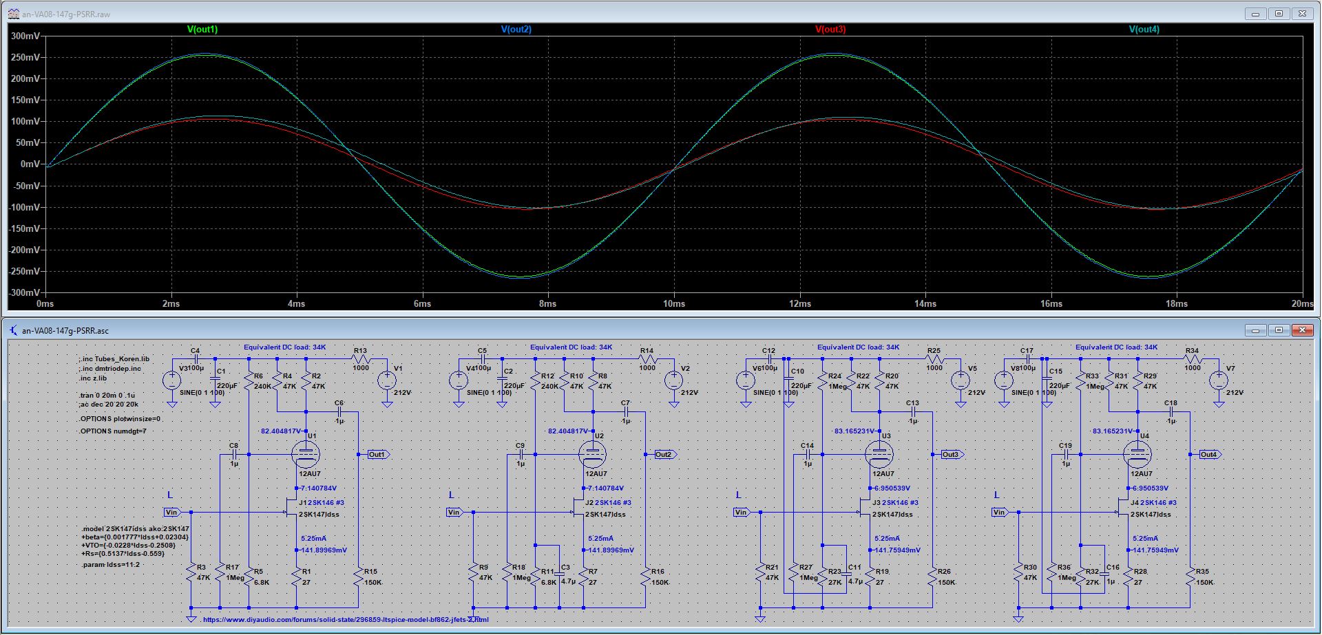

True, I'm confronted with the same issue, and I simply scale down the RIAA EQ to the lower Ra, with lower noise thrown in as a free bonus.

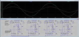

Here's the sim of the various PSRR schemes under consideration; I simply inject 1V at 100Hz to the power line.
- V(out1) is unbypassed upper grid
- V(out2) is bypassed upper grid, the "normal" scheme
- V(out3) & V(out4) are with the Broskie trick and different values

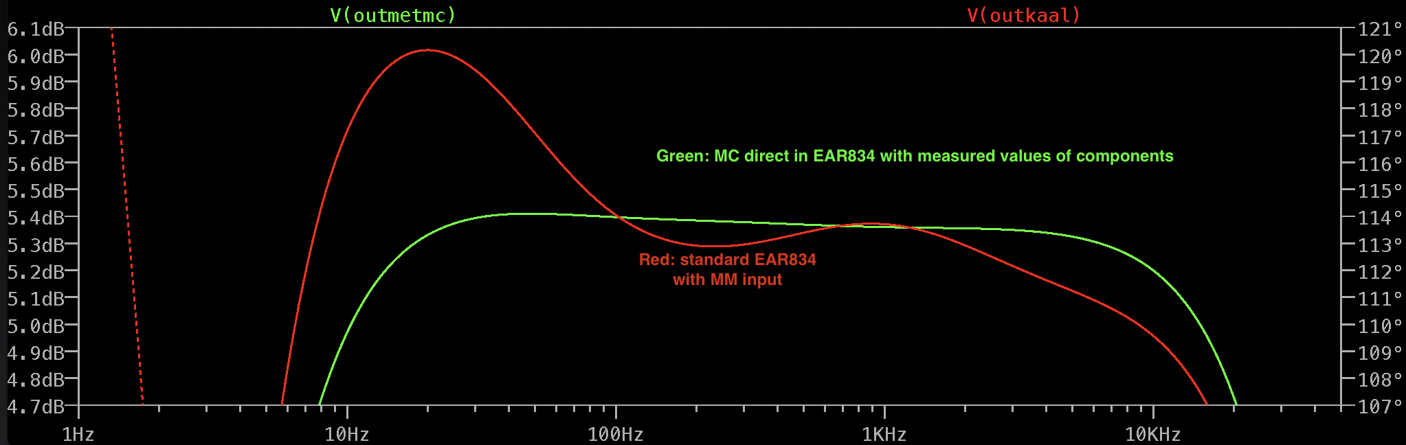

This is with actual measured components (using computerized L/C meter)
Not bad isn't it?
