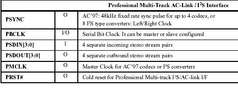

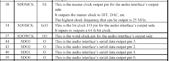

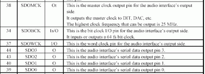

HI Pawelp
M-audio 410 -> XR55
PMCLK -> SDOMCK
PBCLK -> SDOBCK
PSYNK -> SDOWCK
PSDOUT[3:0] -> SDO[3:0]
verify that you have the right frequencies in the M-audio box before you actually connect.
