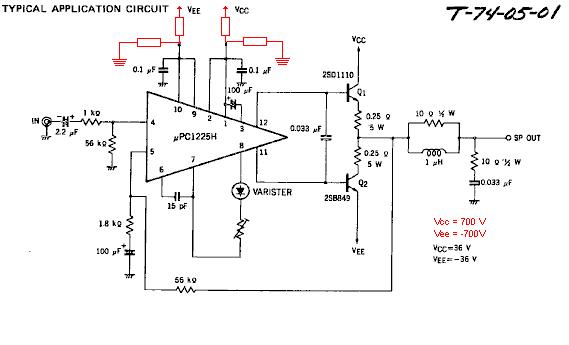

Little question...:
Esl's are mostly current driven, so why not make an current amplifier.
In normal situation a panel is driven by a transformer and one or more resistors. The voltage that effectively drives the panel is much lower...

"..mostly current driven" I say no! They are not dynamic drivers, where a current provides for the magnetic field, but ESLs where the voltage provides for a electrical field. Imagine how much the current varies at constant voltage over the audio frequency band. 1:1000. To achieve a constant current over the whole audio band You´d need excessively high voltages at low freqs.

ESLs work by voltage not by current. It would be practically impossible to build a constant current amp for the whole audio band.

@Bazukaz
It won´t work with this schematic, because the output Trannies work as Buffers with an voltage amplification of ~1. Therefore the driver circuit (the IC) has to supply all the needed voltage which it doesn´t.
The thing could work with added circuitry, that steps up the low output voltage of the IC to the desired high level. But adding steps means adding probs with phaseshift and stability and..and....and........

I think that direct drive amps are generally better then output trannies.
Transformer gives much more distortion than amplifier itself.
ESL's are very efficient.Almost all power is dissipated in amplifier.
So , a new type of amplifier that could use this feature of ESL is required .
I don't even imagine how such an amplifier should look like ...
