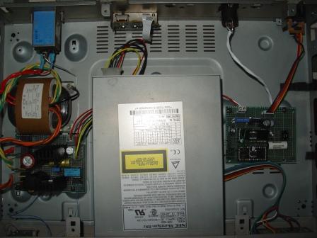

I don't have 26LS32/26C32 but I have MAX1487. I still don't have time to use it. Where can you buy the 26L32/26C32? Normally where can use buy the component in Macau?
74HC04 is the input buffer. For the transmitter, I highly recommend dit4192. It can upgrade any CD player. It turns my NEC6Xi CDRom into a high-end transport. This is PLL1707+DIT4192. It has digital balance output and optical output. So I really want to know the performance of DIX4192 or SRC4192, they support balance input.
