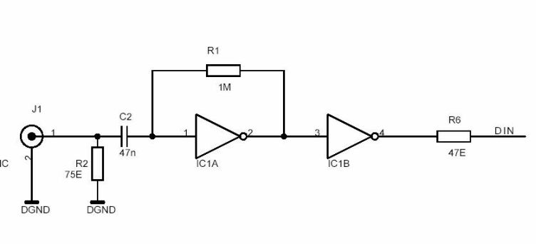

This is circuit which i use for input. Maybe the problem is that i am using 74HC04.
The 74HC04 must be an unbuffered part such as a 74HCU04 for the 1 Meg bias resistor to work. Change R1 from 1Meg to 50K and put a 2K (or 2.2K 5%) resistor in series with the input cap C2 and the input connection to pin 1 and R1 and you will have a very good input circuit that has a gain of about 25 and will sound better than most comparators. For driving the Crystal input receivers (8412 8414 ect) use this circuit to drive a 74HC86 connected as a phase inverter to drive both inputs differentially. This makes an excellent front end circuit and is much better than driving the Crystal receiver directly. I have used this front end and it sounds great. The 47 ohm resistor could be about 25 to 30 ohms for better source termination, but I would not remove it.

Re: This is circuit which i use for input.
Hi Fred,
Do you feel this circuit is better than this one:
http://www.diyaudio.com/forums/show...age=15&highlight=transformerless&pagenumber=7
? (last version I posted)😉
