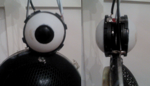

Tuning the emitting area and directivity
A year or three ago I took a pair of very small Vifa OC25SC65-04 1"dome tweeters and glued them back to back to make a very small D dipole dome tweeter. The dipole SPL Vs frequency characteristic was in line with theory as was the directivity, dropping away off axis at higher frequency. I did the same with a similar ( though not as shallow) pair of Vifa 19mm tweeters and again the numbers measured matched the expected outcome.
These two prototypes didnt result in the constant constant directivity and 'full range dipole' I was seeking so I tried another experiment to make the emiting area smaller still.
I estimated that the small area would provide less SPL at the lower end of the tweeters range and set a target that balanced low frequency SPL capacity with directivity at 12,500Hz. My optima worked out to be a 14mm diameter. I played around with the design of a cover that would go over the 25mm tweeter to give me this size, I used the falstad ripple app and some basic theory to check for any downside of 1/4 wave or helmholz resonances and came up with a design that ensured these resonances were all out of range.
To make the cover to the target design turned out to be easy: I took a table tennis ball and cut it in half, I dont have a 14mm drill and doing the hole with a scalpel wasnt as nice a finish as a 15mm dremal sanding bit.
This cover was then glued over the front of the tweeter. The directivity went up in line with theory. The numbers looked good but it didnt sound right.
I didnt find any distortion or resonances from the cover but I found a significant issue with group delay and a peak at the frequency and magnitude coincident with the dipole D distance. I imagine the high directivity and wave guiding spherical shape combined to ensure the rear wave was able to come around to the front at a level that was not prefered.
Doubt a NEO would have the same issues though it should be trivial to increase the directivity with a piece of cardboard. .
