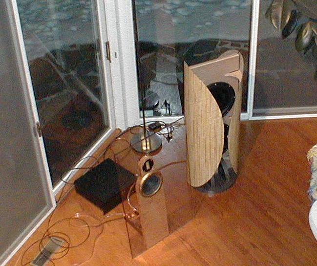

how much can the baffle panel be bent/folded and still act like a dipole design ?
my thought is sort of a woofer panel folded like a taco shell,standing up.
as if you took a full sheet of material and folded it in the middle and stood it.
thinking full sheet of plexiglass.
if you will with the woofers mounted at the fold
or does the design become something else ?
similiar to the lumen white enclosure fold style
http://www.robinkikaku.co.jp/ces2003/2003_01_11/026.jpg
Leave it to me to get hung up on terminology, but, dipole and infinite baffle are complete opposites in my mind. An infinite baffle doesn't allow the rear wave to meet the front wave (infinite separation) whereas a dipole (or open baffle) is allowing the rear wave to meet the front wave under controlled circumstances. Are you perhaps envisioning something like this?

the maple wood has been folded/wraped to create an open back enclosure/drivers mounted at fold,
for the lumen white speaker.

the lumen white speaker sounds good.
except the apprx. $50,000 price

The builders of the Rondo point out that the speaker cabinet sides vibrate intentionally - contributing to the overall frequency response.
To a point. Some real smart person may want to chime in here but, a dipole allows an out-of phase signal to join the primary signal. If the signal from the rear of the driver is controlled to the point where it becomes in phase then it's a bass reflex design. :xeye:
Arrrg!
Just how big is that opening at the back of those Lumen White speakers? The reviewers at Stereophile seemed to think it was a port in the form of a narrow slot. Those reviewers can drool over the quality sound of Accuton speaker drivers all they like, but frankly I think that the enclosure design is the dumbest I've seen all week, even if it does cost a whopping $50000. :whazzat:
In the measurement section of their review, they found that there were lots of nasty internal reflections due to the lack of damping in the box. The woofers had a high crossover frequency which meant that lots of high-frequency sounds got measured through the port. But worse than that: the high-frequency sounds going through the port are totally unclean, with lots of resonant peaks and nulls...

If you want to make a dipole: don't stuff around with some weird and wonderful hybrid design, just make the panels flat or moderately curved. For better bass response without drastic amounts of EQ the panels just have to be big. This is where the "H" designs can help by reducing the apparent size a lot. I don't see anything wrong with a moderate U or V shape, except if it's overdone then the backwave might have boxy resonances. Brainwave: you could make it a reverse U shape, so that effectively a concave parabola shape would beam the sound at the listener. This would also guarantee much less "boxiness" caused by interactions between the back wall and the baffle.
