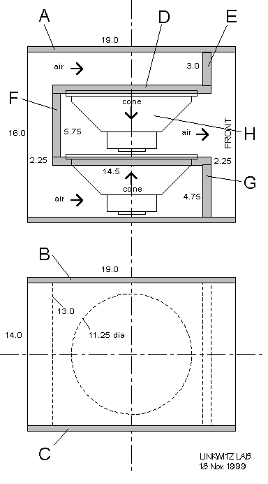

I have been looking into the dipole theory on SL's site, however, I can not find an answer to what seems to be a simple and fundemental question. When you place woofers in opposite directions, ie one magnet facing towards you and one away so that you cut down on even order harmonic distortion, then the two subs radiate 180 deg out of phase directly in front and behind the woofer. So how come these two woofers do not cancel each other out? Does this have to do with wavelenghths of lower frequencies? On the same note, how come mid-bass woofers are not placed this way? For example, if you look at the beethoven midbasses, they are facing the same way!

It is simple actually, the waves do cancel, but only at certain frequencies and at certain areas. I know, for example, that my H-baffle woofer, will cancel at lower frequencies (150Hz. and below, perhaps lower) thus, producing the Dipolar effect. In this case a linear Dipole effect.
I believe that the Woofers are facing opposite direction and that they are wired appropriately (+ to + and - to -). Otherwise, what would the point of firing in opposing directions be? I also, like to consider the waves as propagating from the driver's cone thus, I can infer that the waves do not meet at an appropriate time in which cancellation from waves, directed from the front of the baffle, can occur. Meaning, that the amplitude, phase, and wavelength of the waves are not met. The requirements for cancellation which are of course: a (amplitude)=a, l(wavelength)=l and phase of b=- phase of c.

I'm not sure I followed what you are saying but the drivers should be wired like this in the Orion where each driver gets its own amp. Both drivers move the same direction relative to the listener. Excuse the crummy ascii art.I believe that the Woofers are facing opposite direction and that they are wired appropriately (+ to + and - to -). Otherwise, what would the point of firing in opposing directions be?
+______________+
amp1 ----- forward facing woofer
-______________-
+______________-
amp2 ----- rear facing woofer
-______________+
