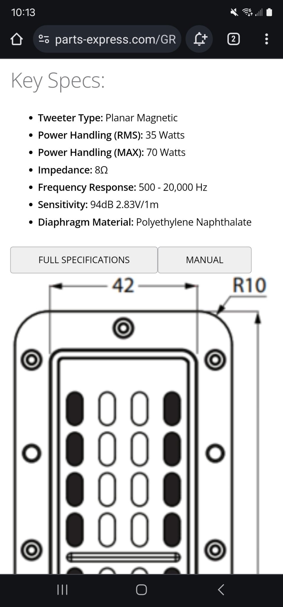

So after more research, the AC AST2560 also seems like it would fit the bill. Anybody selling a pair of those?
Do you guys know of any dipole/open-back AMT (or similar) with 8 ohms impedance? (most of them are 4 ohms)
Most planars come as 8 ohm, and are dipole by design. Not amt though.
Other than GRS, do you know of any other planar brands that do offer 8 ohms?
Mundorf used to have 8-ohm dipole AMTs in their old models, but not anymore.
