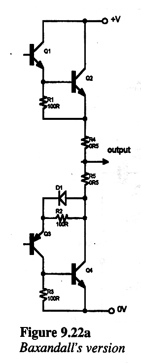

I read a letter to Electronics World magazine from Jim Bongiorno just the other day in which he claimed that crossover distortion in power amps had been cured many years ago by the use of diodes in place of the emitter resistors in the Marantz Model 15 power amp designed by Sid Smith and that he had later improved on this by using a combination of schottky diodes and resistors in a later design of his own....
In my many years of involvement in audio electronics I can't recall ever seeing this topology and a google search of the subject has come to nought!
I'm assuming that if there was really any mileage in this it would be commonplace by now!?
Anyone familiar with the idea and care to comment on it?

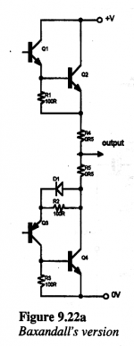

There could be other reasons: Baxandall diode fe.

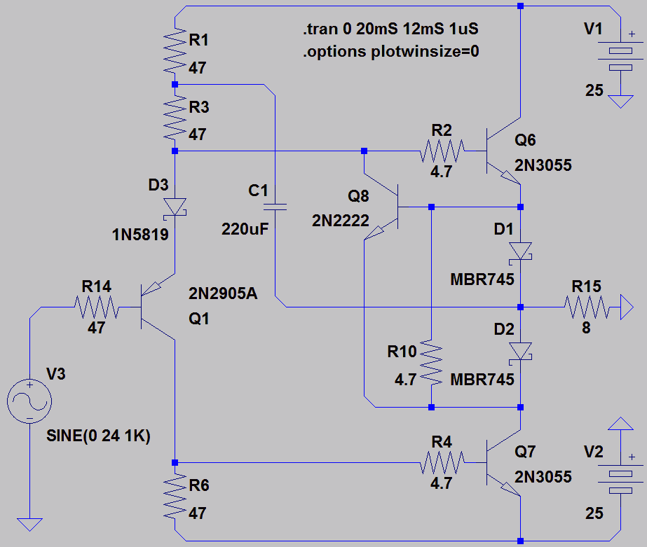

Or something completely different: in the Circlophone©, resistors serve purely as current sensors, and have no effect on the transfer function.
They thus have a relatively large resistance, to maximize the sensivity, and they are shunted by schottky's at high current where they play no role, to avoid wasted power.

My two pennorth: diodes are highly exponential just like transistor bases. Therefore, to remain even approximately linear, they need to be biased on, slightly, just the same as a transistor. If not, either they will cause a high non-linearity when they do (for the case where diodes are in parallel with the emitter resistor) or the output stage is not biased enough (in the case where only diodes are used) and the output stage will be operating in Class B as opposed to Class AB and have a high crossover distortion anyway.
Using diodes it seemed to me was a crude trick to try to control quiescent current at the expense of linearity.
Yes, exactly. To a first approximation the diode has the same response as the thing you are trying to correct. It is a bit like adding an extra BJT to a Darlington, except that this one has a beta of 1.

Does anybody have a schematic of the Marantz Model 15. In the meantime we can probably that the emitter resistors in question are the ones attached to the output devices. Sounds intriguing, but if it worked then why isn't everybody doing it today?

I've seen something like that in a few guitar amps. Basically a diode in parallel with 1 - 5-ohm emitter resistor of one power transistor. But they have always had the typical low-ohm emitter resistor in there as well as well as the the ordinary vbe mult bias circuit + thermal compensation. So, I hardly see how the diode would have mysteriously solved anything.
If I rememeber correctly, the Marantz scheme was somewhat unique but basically not too different from the scheme of using diode voltage drop to bias the output devices. In Marantz the diodes (if I remember right) where just placed in another place instead of the usual between driver bases location. Effectively the biasing means with diode voltage drop varying with temperature was still the same - and just as bad as using only plain diodes for the task.

Found this on the website of Bongiorno's current employer. It appears to say that the Marantz Model 15 was NOT fully complementary, but the amp JB worked on next (SAE-31B) WAS fully complementary.
So if the Marantz Model 15 was not fully complementary, perhaps it was Quasi complementary, and perhaps it benefited from the Baxandall diode.

Maybe I'm mistaken. I'm far from an audio expert, but has not elvee just accomplished this? from the thread:
...Here is something different for a change:
It combines a circlo output topology with an active bias servo.
The servo stabilizes the quiescent current, but it goes further: it actively controls the output stage so that both sides always remain active in a "warm" class AB, having most of the attributes of the full class A, including a complete absence of crossover artifacts.
Meet the Circlophone©!!!

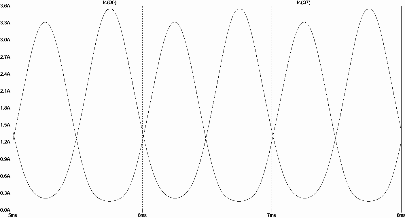

For my surprise I've just simulated an amp adding in parallel the SCHOTTKY's B560C to each OP BJT Re (.22) and THD is better by a 7% at 10KHZ and 16% at 200KHZ, other conditions equal (560 ma AB bias) OLG profile not changed .... small signal OL distortion is the same for both cases, what intrigues me is the little but noticeable reduction of THD with the SCHOTTKY's when closing the loop ???
