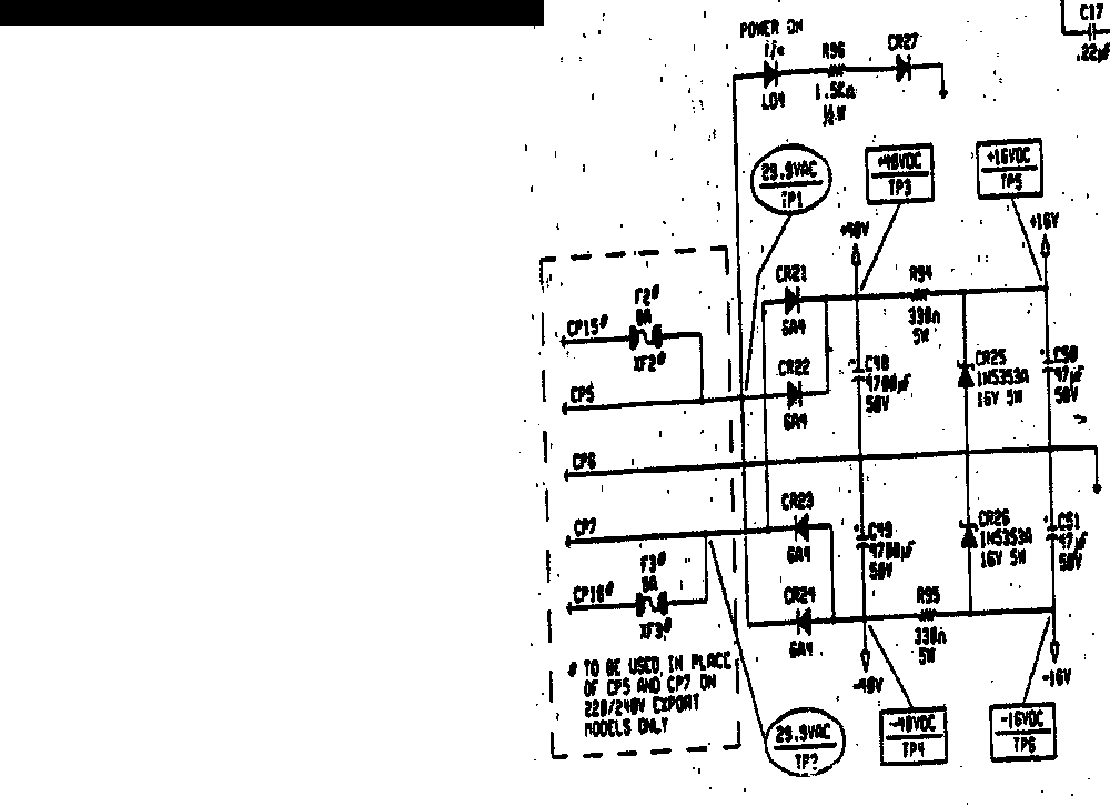

I am trying to fix a fender m80 solid state amp. It works, but there is one section of the board that is literally burning hot.
If you would please look at the partial schematic, my problems are resistors #94 and #95, and zener diodes CR 25 and CR 26. All the other resistors, diodes, and caps test OK (I think I know what I'm doing ). :clown:
All the voltages are OK. No other components on the board are even warm. I've replace the four components (although I had to put in 1N5352 instead of the original 1N5353 zener diodes), and the problem is still there.
I'm assuming that there aren't supposed to be burning hot components on the board!!:clown:
OK, I've thrown down the gauntlet...please help!!

NORAA,
Looking at the power ratings of the resistors and zeners (5W) it could be normal behaviour.
If possible, I try to mount them elevated from the PCB or at least resolder them. What current is running trough the R's?
/Hugo 🙂
Hi NORAA,
Yup, they will be hot as heck. 50 V (ish) dropping to 16 V through a 330R resistor means the diode will dissipate 1.65W with no other load connected. The resistor will always dissipate 3.5 W. That is very hot.
How much is the current draw from the op amps? I'll assume that is all that the circuit supplies power to. A voltage regulator stage might be more intelligent.
-Chris
Edit: Hugo, just over 100 mA. C48 and C49 should be rated at 63V. They may be opening up by now.
