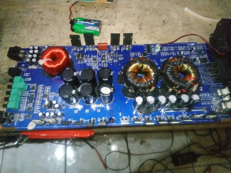

I can't cross most of the diode markings but you need a high-speed diode that can easily withstand the full rail-rail voltage.
The ES1G and ER1D (similar but different size and voltage) are used in some amps.
These ones we got here in south africa dont use driver boards its just one board from energy audio

I only took one picture now as its night and my lighting aint good
