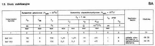

BAP811 was produced in UNITRA CEMI (Poland) a few years ago; Zener diode in TO-92 case
IF: 0,05A, Tjmax: 150C, Uz: 1.45-1.65V IR: 1uA for UR: 6V
It means that you can replaced it by 2 ordinary, low power silicon diodes, like 1N4148, coupled in series or even two CE junctions of low power transistors connected in the same manner e.g. BCxxx.

The link below leads you to a catalogue but in polish language.
http://www.eres.w3.alpha.pl/index1.php?text=25
