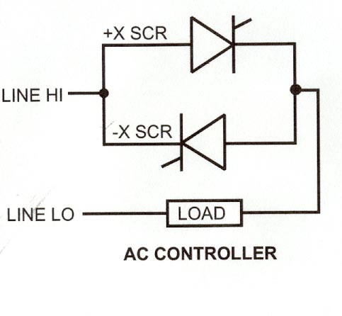

Quote from mlloyd1
I seem to remember that the voltage to the transformer was applied gradually by the triac (functioning as in a dimmer circuit) as opposed to replacing the relay that would simply switch out a resistor.
Something like this, but with a triac in place of the 2 SCR’s and being triggered by a cap and resistor circuit across a voltage divider. The cap would be charged through the resistor right from the AC line. The resistor value (or pot) would determine the firing phase of the triac. You would have to full wave rectify the trigger AC for the triac. The SCR’s would need a + and – trigger circuit with no rectifiers. The load in the pic is the transformer primary.
It could be even more fancy using a "one-shot" for a trigger.
Rodd Yamas***a
