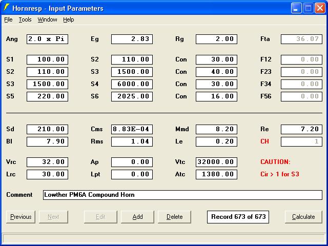

Hi CLS,
Hornresp Version 21.00 can model conical and/or exponential compound horns. The attached screenprint shows the input parameter values for your design assuming radiation into half-space, but with the oblate spheroidal waveguide approximated by a conical horn.
The Combined Response tool can be used to show the overall output from the front and rear horns.
Kind regards,
David

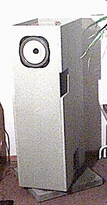

Hi hm,
Actually I've looked into some of your designs, they are very interesting indeed.
However, when a 'horn' is largely narrowed, it's character tends to a "pipe", that is, a zig-zag response and lower efficiency.
I back-engineered an Acousta (with PM6A), and got this:
(placed at 1/4 space -- 1 pi )
Like very many other "commercial products", the CSA's along the 'horn' are highly reduced, thus a bad looking response and lower effeciency.
Getting into such 'trouble' of making a horn, I really hope a good result and don't want such a compromise.

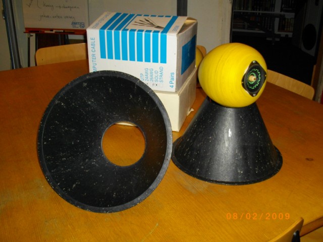

Hello CLS,
I'm working on a simular setup for my lowther DX3
Also simming with hornresp.
Will follow your progress with a lot of attention.
I also studied Horst's work with interrest !!
Very subttle approach!!with a "filler"driver.
But to my regrets I must admit that I'm a purist.
So I'm going for ONE driver!!
James M. explaines in his paper that there will still be a hole from 300-1000Hz after using a BLH.
BLH only works till about 300Hz ( Horst says the same, I think)
So filling this hole with a front horn only seems justified!!
Question of finding the right balance between front and back.
Beauhorn uses this principle, and reading about Beauhorn, they seem to be "warm"sounding ; exactly what I'm looking for.
I found some round conical pieces that I would like to use as a fronthorn.
I will post a pic later this day.
Great to get some advice from the man with the hands : Horst, and the great Scott as well, this will be a stunning topic!!
Planning on using this as a conical front horn.
size diam. large : 35 cm
diam. small : 15 cm.
length : 20 cm.
I will need a front box as well, calculated 0,5 liter.
Or I will have to trim the small diam. till ~18 cm , lenght resulting in 16 cm.
My mini bamboe Ikea speaker, with a foster 085 for size comparing.

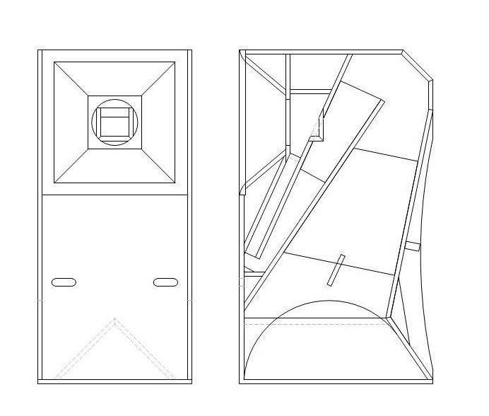

From my own very limited experiences, hornresp is quite accurate. The results of the real things are very close to the simulations. (And I remember reading many other's similar comments. ) So I inevitably use it for planning.
If I've already done many trial and errors and had my own 'database', then I'd be more confident. But I have not, so now I choose to trust the simulations. OTOH, my friend trusts me blindly, it's almost a bet for him. I'll give him the drawing and he'll pay for the carpentry and drivers. I'm not quite sure what he will finally get....
For higher efficiency, I go for horn eventually and ended up with something like the attached drawing. (And it is now built by a professional capenter... )
According to the sims by hornresp, the combined responses changed significantly with the path length variations. So I placed the horn mouth to the sides of cabinet and expected this can provide a multiple differences thus averaging out the irregulations of response.
Hope it'll come out all right.
