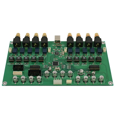

I'll show you my work. This support the balanced input and output with unbalaned mode. ^^It controlled by remote controller and rotary encoder..Even it is controlled by USB-based PC Software.

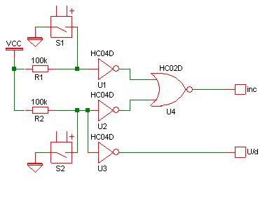

Giaime said:The DS1666 can work with pusbuttons and some glue logic, no need of microcontroller.
That's a bit more complicated than just two simple switches and requires two extra active devices, but I guess it's easier than programming a micro.
Maybe I will see if I can get one of these working (not that I need it). I think I have all the parts.
Can one of the above circuits control two DS1666?
Take a look at the attached schematic (found somewhere in the Net - the autor will forgive me):
hey Gaime, im a fan of AS Roma 😀 Is this circuit work well?Im not really good in circuit analysis. 😉

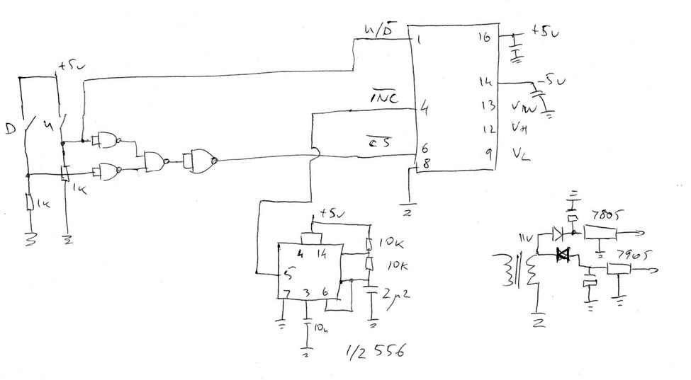

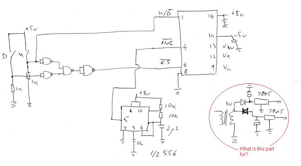

Would it be possible for you to draw up how you did it with the 555 (plenty of these on hand)?
Thanks.
Turned out it was half of 556 so pins will need to be corrected. Complete with a cheap skate PS.
I only used this for a day or two as it's way too masochistic to use push buttons with no position indication. Currently i use a rotary encoder with no indication again (box too pretty to drill extra holes) which is miles better. I find ARC style leds around a rotary knob simple and useful.
The entire reason i mess around with electronic pots is that balanced switched attenuators require way too much dedication and easily fuel audiophile neurosis. What switch? What resistors? What solder? Should i now replace all 160 resistors with bulk foils?
These are certainly inferior but dirt cheap and easy.
