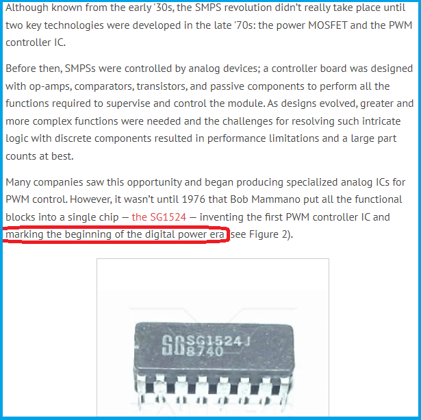

However, the term "digital" originates from the SMPS type of power supply and has then become a misnomer for the entire amplifier.
"There is no clear consensus of what the term digital power means in the SMPS community. This can be attributed to a number of factors including the early introduction of digital technologies back in the '70s with the first PWM controller IC, the various levels of digitalization happening in the last decades, and, of course, the creative nature of the marketing brain. In fact, the switching action itself — which gives the whole technology its distinctive denomination — is in essence a digital phenomenon. Despite this confusion, the technological evolution of the modules is historically clear as we will see in this section."

No, it does not.the term "digital" originates from the SMPS type of power supply
I think the 'digtal' term comes from the on/off pulses (i.e noughts and ones) found in PWM devices.No, it does not.

From the same link I posted above:
https://eepower.com/technical-articles/digital-power-for-switched-mode-power-supplies/#
