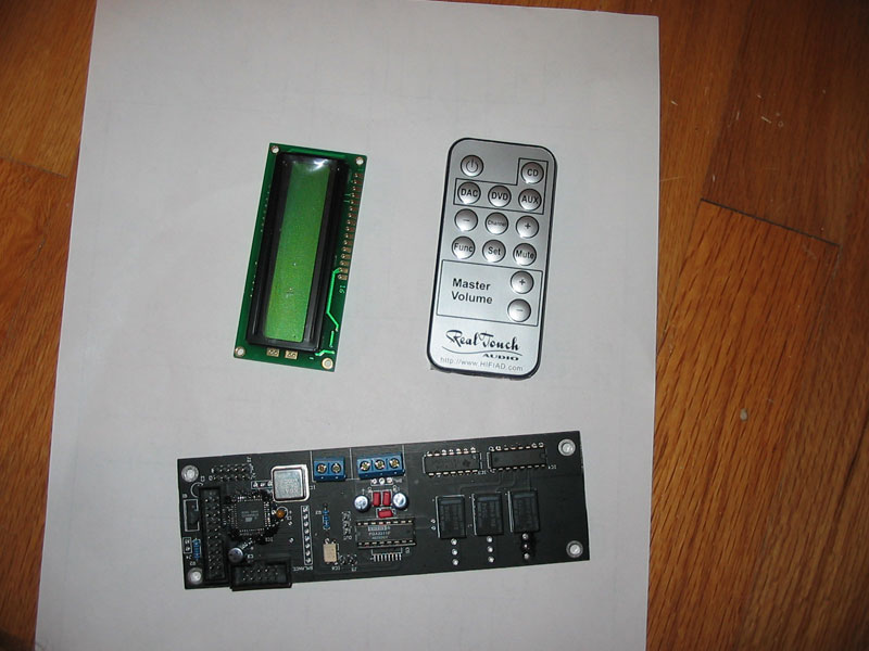

Also, my PGA2310 project
http://mywebpages.comcast.net/gillespie147/Junk/PGA2310-REV2.jpg
