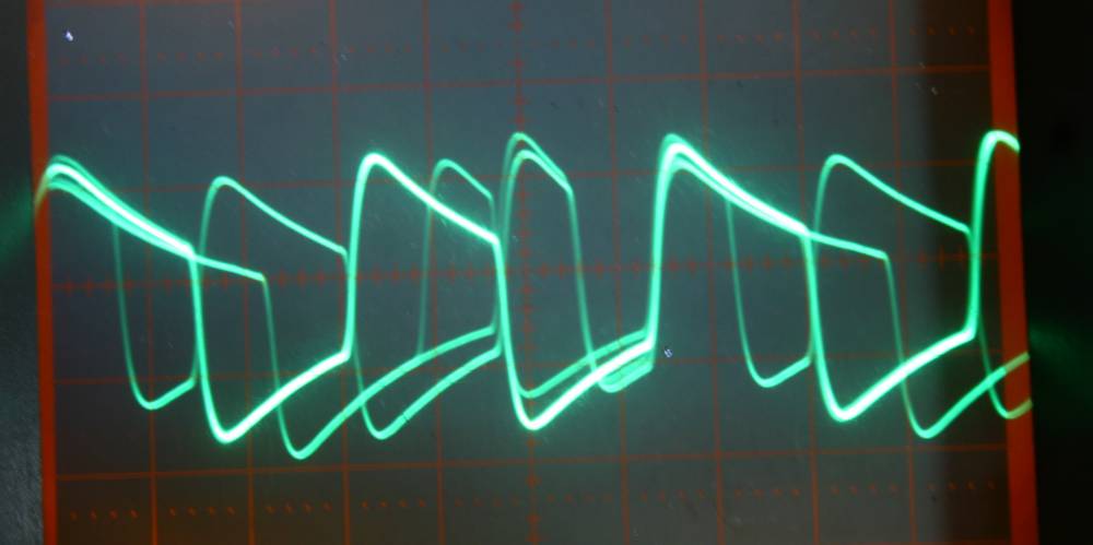

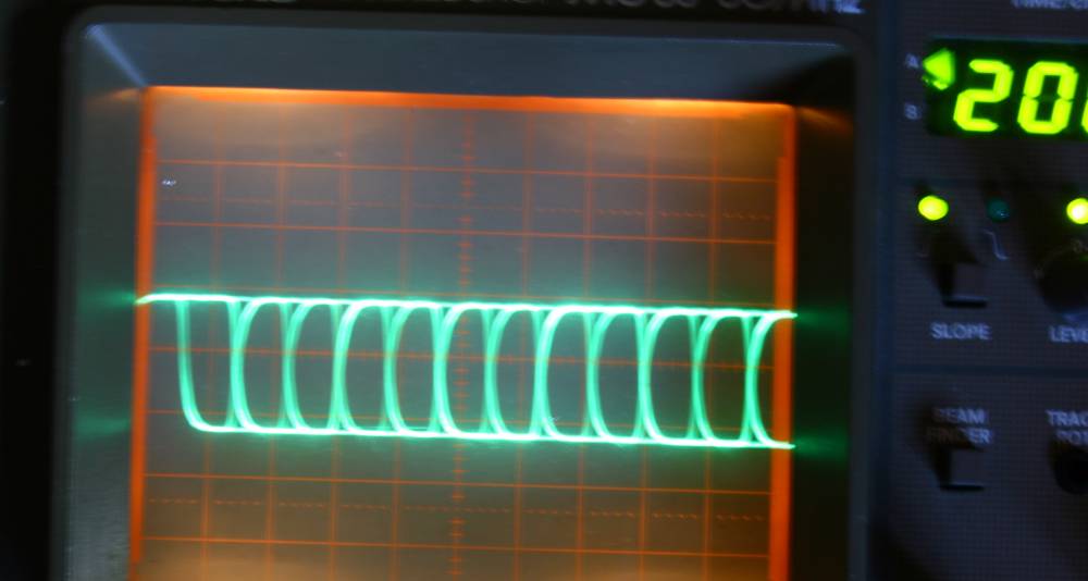

Well, Here are two images from the same player, before and after mod ala Lukasz. The first image is easy to believe as not sounding as good as the second...
Why?
Well, Here are two images from the same player, before and after mod ala Lukasz. .
Just a cursory eye-ball but certainly looks to me as though your mod has added jitter. The zero crossings are looking wider - meaning the eye pattern is closing.

I can agree that the signal seems to have added jitter, but the focus of the photo is poorer thou...

As ín the digital world the signals are intepreted as either "1" or "0". You know this, but I will explain furher 🙂 In the ocillogram posted of the bad signal, you can see that the zero passages are divided in time, that are, they dont come regulary in time. And when such signals are transmitted thru a coax, or balanced cables, especially if the impedances not are matched, the signal gets more distorted in the timedomain. So when this distorted signal reaches the DAC, the signal is distorted and so is the output from the DAC.
In the second oscillogram the signal is with less jitter, and with much less distortion of the square wave, as it should look like when arriving at the DAC 🙂

Trying to judge jitter on an oscilloscope is useless. Absolutely the wrong instrument for it.

Again, an oscilloscope tells you nothing about the jitter. It's the wrong instrument, and when you interpret the wrong measurement the wrong way (by eye), you end up with wrong conclusions.
The important jitter is at the DAC, not the external datastream. And you can't use a scope to measure it there, either. You can look at the analog output, which is all you really care about anyway, and see if the interface differences result in any kind of actual difference.

erez1012, to me that waveform is perfectly OK, and cannot be bettered in anyway. But where did you take this curve, at the output of the player, or the SPDIF input at the DAC?
This is how the waveform should look like when it enters the SPDIF input at the digital receiver in the DAC.
that waveform looks perfectly fine.

The left one has too much highpass filtering, probably due to a too small capacitor or cheap transformer... the one on the right looks OK...
