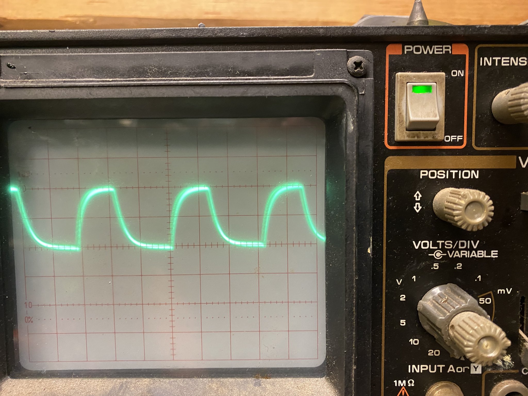

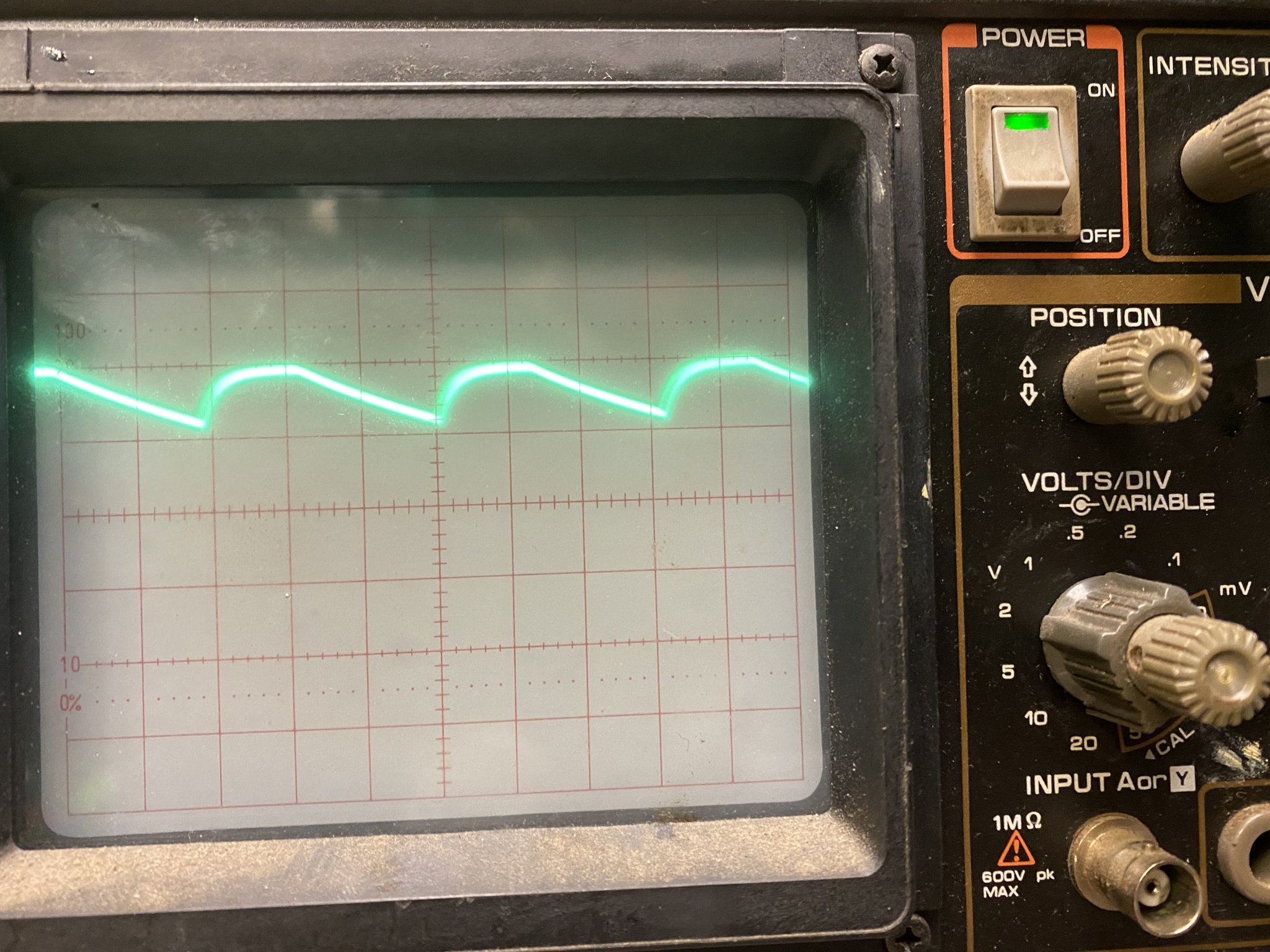

So I should replace all 24 power supply fets correct ? The original drivers are C3228,A1275
Are the BD139,140 still the best replacements for the drivers ? Or is there something better ?
In the image im does it appear the drivers are defective or possibly a diode since the drive isn’t being pulled back to ground ?
scope set to 5us 5volts/div
