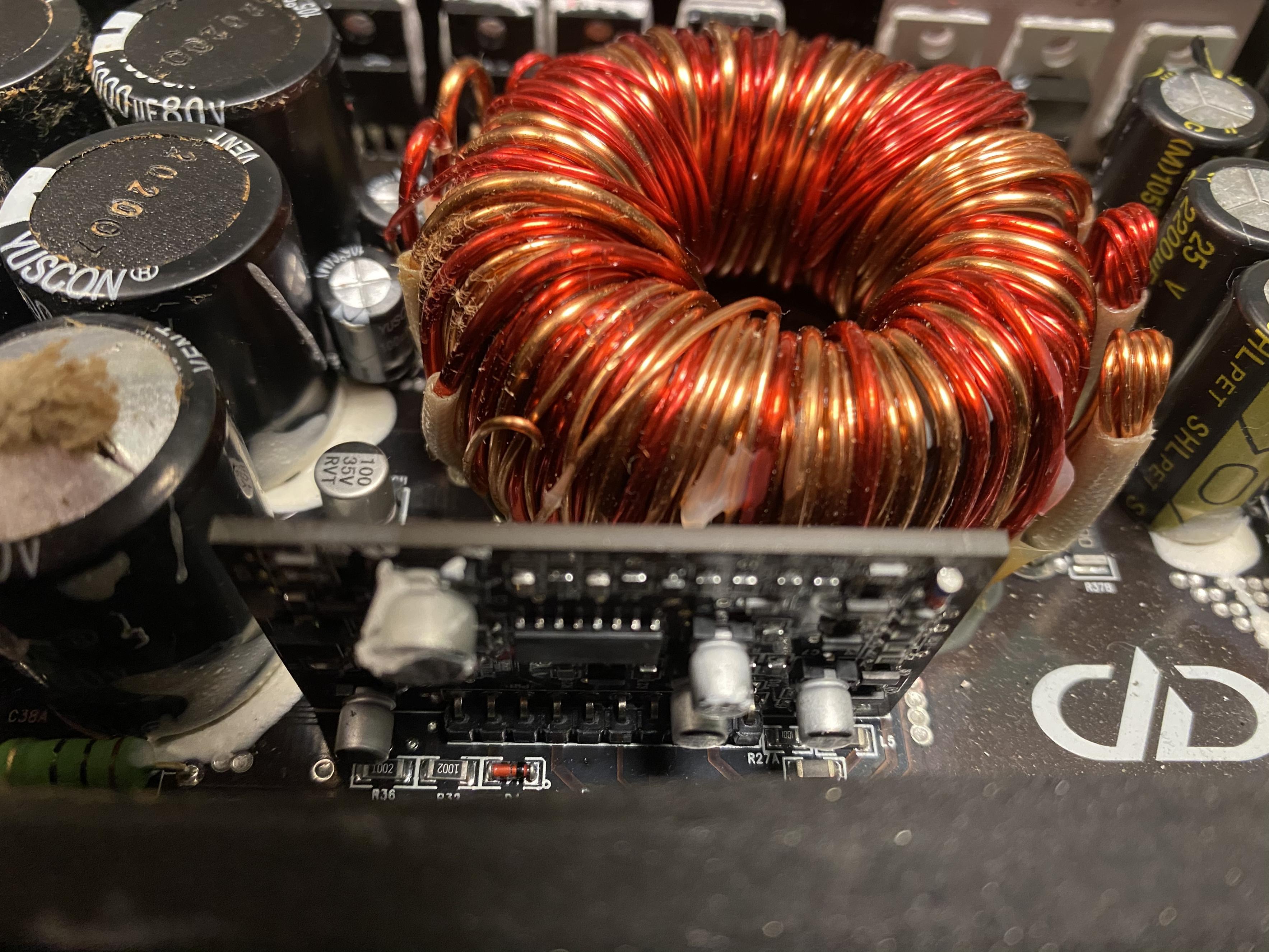

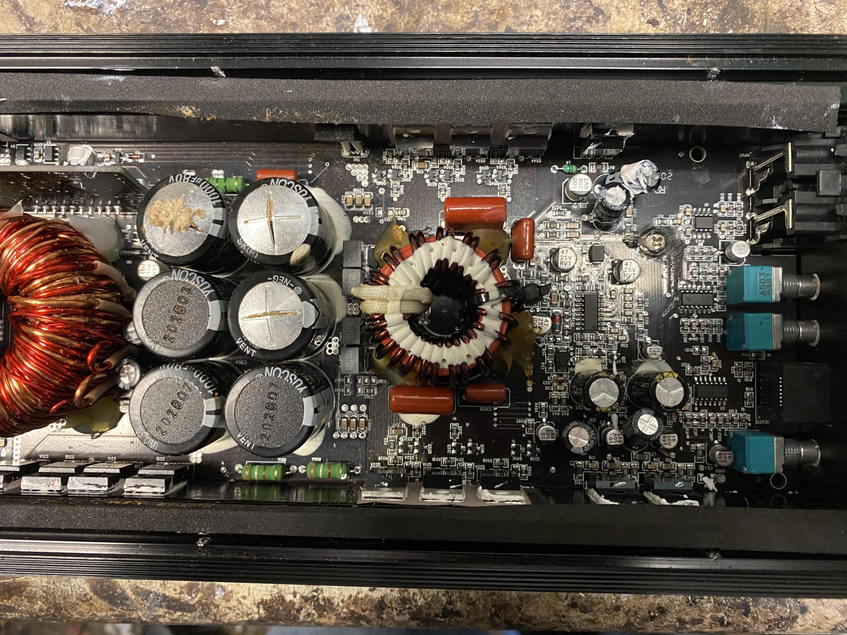

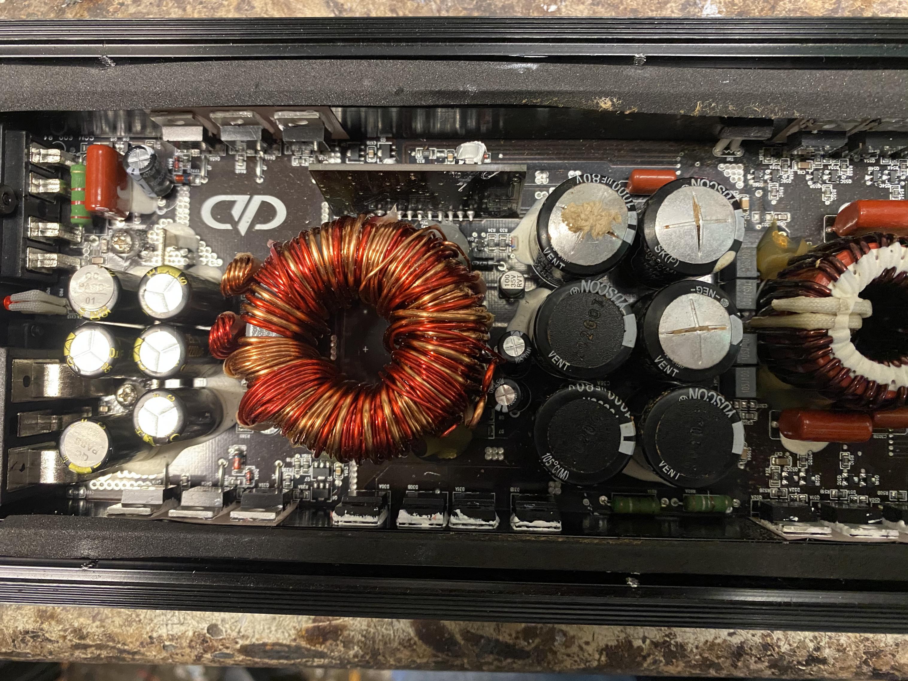

Wondering what would cause all the negative rail caps to explode ?
I checked the power supply fets,outputs, and everything checked done it’s just the rail caps that exploded. They are 1000uf 80v

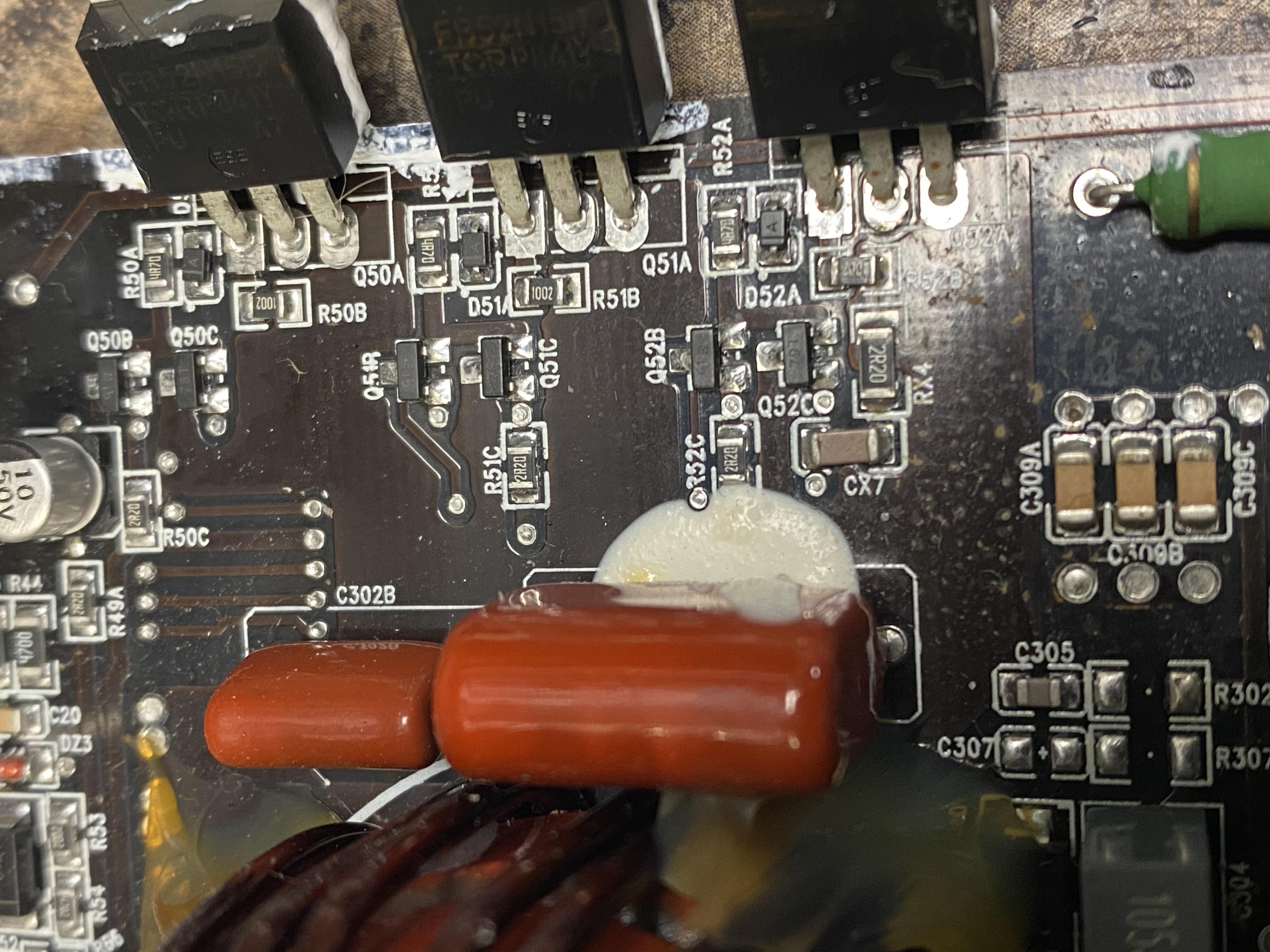

This is typically due to the low side FETs not being driven correctly. It appears similar to the Q124/125 failure in the 'type 2' amps (for those with the tutorial).
The snd transistors appear to have run very hot in this amp .
1 of them is marked G1 the other one looks like 79T any idea what the transistors are ? Part number
This is the best pic I could get of them .
When replacing them should I also replace the IRS2092S driver ic ?
Q50B,Q51B and Q52B are 2n5551
Q50C,Q51C and Q52C are 2n4351
The 2N5551S (SOT-23), DXT5551 (SOT-89), DZT5551 (SOT-223), KST43 (SOT-23), KST5551 (SOT-23), MMBT5551 (SOT-23) and PMBT5551 (SOT-23) is the SMD version of the 2N5551 transistor
The FMMTA55 (SOT-23), KST55 (SOT-23) and MMBT4354 (SOT-23) is the SMD version of the 2N4354 transistor

See post above . I also noticed I have 2.33 volts measured directly across the speaker terminals.
Ok I think I figured out the problem .
The smd transistors all read shorted and it appears they ran hot .
I will order new and replace them and test it
