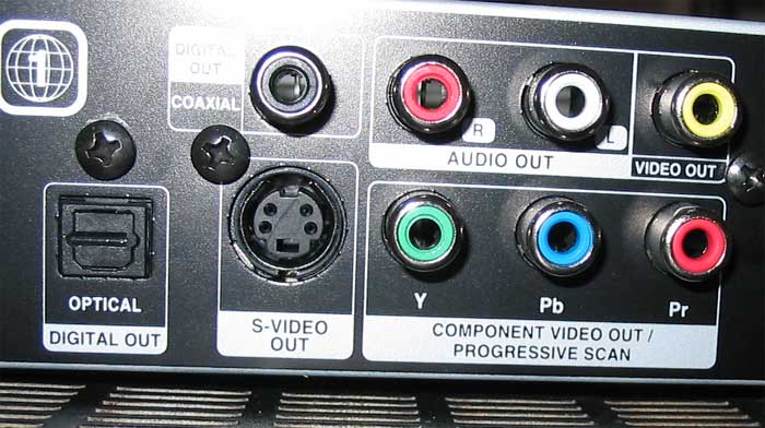

this will work for my home cd player right ? as it has optical out and digital optical out.
If you do not have a electrical digital out availeble, but only optical digital, you need to convert it from optical to electrical ....

use the coax digital out to the DAC you'll be buidling...but if u wanna try optical (as it is isolated) then build a small adapter as described...
