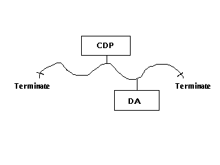

Thanks, kind of what I thought. I know all to well what reflections can do after working with networking for a fair amount of time and learning quickly the difference between proper and bad termination.
As a reflection (!), did you, or somebody else that you know of, ever test to use a much longer cable than needed and put connectors at reasonable distance, say less than 1 m, but extending the line some extra meters from both end points and terminating there. I just thought that maybe one could get the reflection attenuated slightly and moving out in time to where it could be less harmful. Stupid or interesting?
If you have reflections at the reciever, they propagate from the reciever, not the end of the cable.
You might /also/ get reflections from the cable end though with this termination. Not to mention that driving a 25-ohm line is rather hard. ^_^

tiroth said:If you have reflections at the reciever, they propagate from the reciever, not the end of the cable.
I am not sure that is how it works but I know that both ends for a 50 Ohm network need to be terminated with 50 in this configuration. Also I suspect that a reflection is not only a one-off thing but it will reflect at the receiver end back to the sender end and then reflect back again until the reflection has been completely attenuated. By moving the timing out and keeping the connections close (or rather at a perfect distinance) I thought soemthing good might come out of it. Just a thought as usual...
If you have an ideal transimission line properly terminated at the far end, there will be no reflection. The question becomes how far from ideal is the transmission line in question?
Let's say you have an S/PDIF driver wired with some traces to a 75Ω BNC connectors, then a 75Ω BNC cable to another 75Ω BNC connector with a 75Ω terminating resistor and some traces to a receiver. Where does that depart from the ideal? Each connector introduces an impedance discontinuity, from which the signal will reflect. When these reflections reach the transmitter, they are reflected again back to the receiver. This second-order reflection, and all higher even-order reflections, are the ones that can mess up your signal.
The usual way to deal with a problematic second-order reflection is to terminated at both ends, which will attenuate the reflection from the source. The side effect is halving the signal amplitude, but often this doesn't matter.
So, why does cable length matter? The cable length determines when you will see that second-order reflection. If you think of the cable as a fraction of the wavelength of your signal (determined by the risetime, not the frequency), you can determine when you will see the reflection. Taking the example of a signal with a 15ns rise time (i'm guessing here, what is it for SPDIF?), the wavelength on a coaxial cable will be over 7m. Therefore if you have a 0.5m cable, any reflections will be added to the edge that produced them, causing overshoot. This will not flip bits, but it can artificially increase the rise time, leading to jitter.
Take the other extreme. Suppose you have a 30m cable. The second-order reflection will be added at some random place in the signal, probably four or five pulses after the pulse that created it. The poblem with jitter is still there, and a new signal integrity problem may arise. You won't need to worry about it if the reflections are small.
