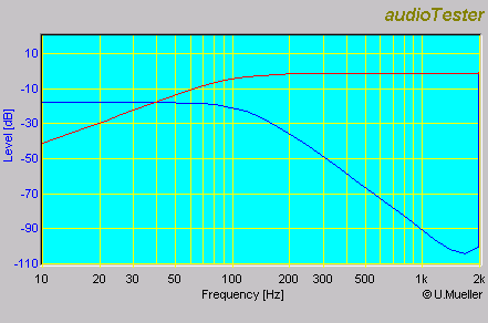

This is what the sub output looks like:

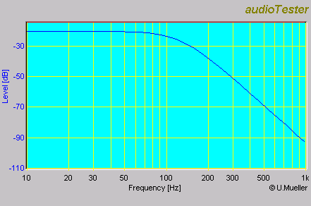

The sub LP filter is 24dB/octave at 100Hz. Fortunately most audiophile applications will probably cross the sub lower than this, so the filter won't interfere too much.
The speaker size setting only affects whether or not a 12dB/octave filter is applied to the main channel outputs; the sub crossover is the same.
As you can see in the last pic, the digital filter cuts off suddenly above 1.5kHz, so you'd better have another filter taking over at some point. 😉

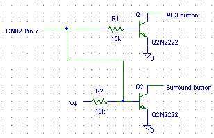

Now what do you do with this? I'm using it to get a digital line to send to a Behringer unit to do bass EQ. If you do multichannel audio you could also use it to grab the center channel for EQ, but then there is a need to switch the mode. I am considering how to add a circuit that automatically switches the mode depending on the input. Not quite sure how yet but it shouldn't be too tough.
