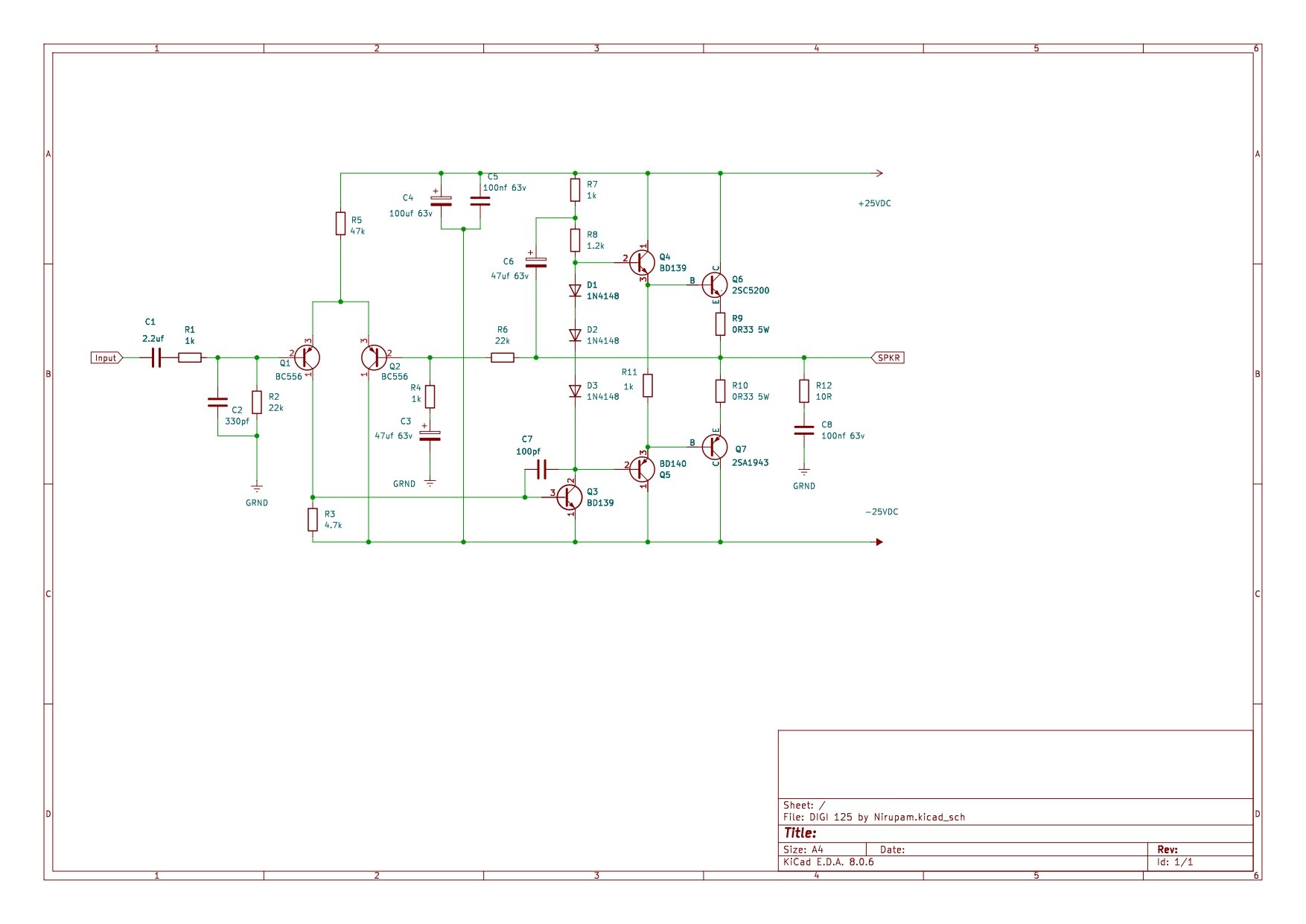

Hi everyone, due to utter boredom i desided to build some amps for fun. I wanted to start from a quasi complimentary amp designed by forum member WhiteDragon but later i thought why not begin with a simple classic design like DIGI125 (ETI, MAY 1989). I hve drawn a schematic based on the original design with very few modifications like bootstrap, zobel etc.
I already made some changes and there's many ways for improvement but i want to keep the design as simple and original as possible. Vanishing THD isn't my goal & for that much better designs are available.
