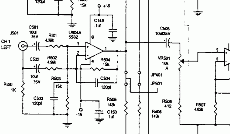

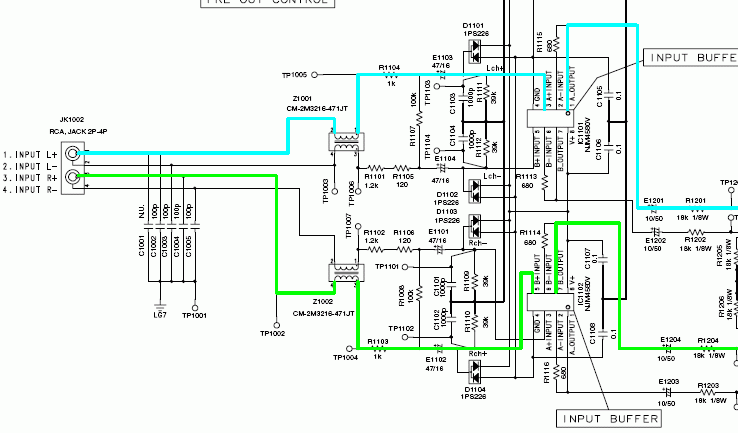

Some amps have input like this. While the input is RCA (not balanced), the receiver is configured to sense differential between + and - (like balance input receiver).
Both the + and - are passed via capacitor (E001-E002-E003-E004). The - (shield) is not connected directly to ground, but by capacitors (C021-C022)
What is the merit of doing this? Better sound? Breaking ground loop?
Why not just connect the shield of the RCA directly to ground?

The input circuit is a balanced circuit. It amplifies the difference between the two inputs. It just so happens that these two inputs are the 'hot' and 'cold' of the RCA, but it could as well be pin 2 and pin 3 of an XLR.
The advantage is that there is no direct connection between the two grounds of the source and the amp, so no possibility for ground loops that, which could set up a voltage across the ground lead, which could lead to hum etc.

the problem with both of these circuits is that they present different impedances to ground for both +ve and -ve inputs. I think this is what lumanauw was saying. Consequently, common mode signals aren't cancelled effectively.
The imbalance added by the resistor/cap to ground is an attempt to resolve the problem caused by using a single ended, screened cable. When the source is single ended, more 50/60Hz leakage current flows in the screen than the center conductor and so the use of balanced input is broken. These are both attempts to re-direct the leakage current away from amplifier input.
Let's be honest here. A differential input only really works with a balanced output and twisted pair/screened interconnect cable.

Hi Lineup,
You posted as I was composing. The differential stage you show is truly differential as it hasn't been degraded by an impedance to ground on one limb.
The 470p to ground in Lumanauw's first circuit presents a 5.6Mohm impedance to ground at 60Hz which won't affect the input impedance balance very much - agreed. It will generate a significant voltage due to the leakage current flowing in the shield.
The 1K to ground in the second circuit reduces the input impedance seen by that leg to 830ohms compared to the 4.9K seen by the other leg - a significant imbalance.
But a differential input is only one part of a balanced system. You also need a balanced cable and a differential output to drive it all.
When you use RCA connectors and single conductor + shield cable, you typically have a single ended output with the shield connected to chassis at the source. The leakage capacitance to the chassis of the source is much greater than the leakage capacitance to the shielded, single ended source output and so a greater mains leakage current will flow in the shield.
You need to take a holistic approach, looking at the complete system. That was my point.🙂

Ian,
David's input circuit in post # 7 *does* have equal impedances, which, as you say, is very important for CM rejection.
Edit: I overlooked the 1k. That should indeed go.
I cannot agree with you that you absolutely need a balanced output. There are two issues: equal impedances, which are essential for maximizing CM rejection, and balanced signals, which are important to maximize signal levels (and thus S/N ratio) for a given supply headroom.
But you can have great CM reduction from equal balanced impedances with SE signals, as long as you use balanced screened cable of course.

Differential sensing of RCA inputs are done to break ground loop in noisy environments such as in vehicles especially from head unit to amplifier. This way the common mode rejection of opamp is used at its full potential by configuring the front end as instrumentation amplifier providing very high input impedance and after that conversion to single ended by differential amplifier. This is to reject any out of band noise such as hum/hiss or RF.
