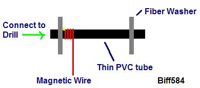

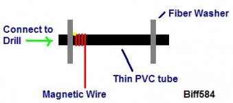

I don't know if this would work -- but I've wound solenoids out of magnetic wire before-- I put a thin piece of PVC pipe in a drill set to low speed and hot-glued the magnetic wire to one end with two fiber washers on either side of the pipe. Then I just guided the magnetic wire up and down- it worked pretty well and I got a nice, uniformly wound coil.
-Brian

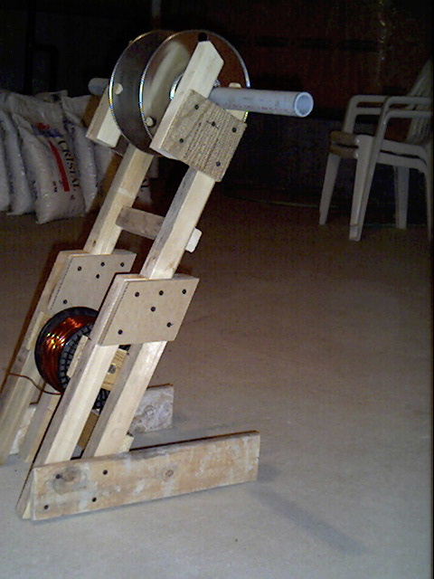

Re: Need help designing the top
chris ma said:
I need some ideas to build the top wheel and able to remove the coil after winding,
Any ideas?
Chris, I hope your not thinking of winding the coil over the pipe.
Assuming you will be making an air core inductor:
What I would do with the setup you show is to build a smoth cylindrical but somewhat conical core were you will build the winding. Most likely a machine turned piece made of hard wood or metal with a cental hole to pass the shaft, you don't need a 1" dia. shaft for that, maybe a 1/2" solid will do.
The other thing to solve is how you will attach the side plates for containing the winding. A simple solution would be to put a couple of srews to hold them to the core mandrel. The other way would be (somewhat more costly or complicated to build) to have the shaft with thread on the area of the mandrel and add two nuts to press the plates against the mandrel.
Care should be given to size the coil in relation to the wire cross section this will help to keep the coil from deforming when you take out the plates and core. You can help to retain the build by adding adesive tape every two or five layers around the coil.
One last thing you may want to consider is adding a crank to the shaft.
End plates for coils.
Maybe we can use rejected/damaged Cd's or CD-R's as end plates for the coils. Can cut it down to size as required.
Insert a pvc tube that fits the hole size ( or increase the hole size) and glue it with epoxy or equivalent. The quick set type would be useful. Leave the extended tube in place till the winding is over and then cut off the excess. A hole at the end of the tube with a rod inserted would act as a crank to rotate the tube for winding the coil.
An even sturdier former could be made if you insert another tube over the tube used in the explanation above. This bigger tube would be the length ( or height) of the coil and would keep the CD's spaced apart as required. The glue on this would hold the end plates very well I guess.
