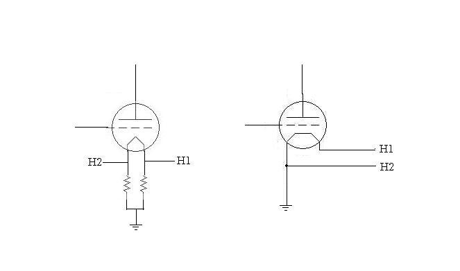

the one with the resistors is supposed to in some way reduce the hum. i`m not really sure how it works, coud someone shed some light?

www.loginnovation.com/jeapel
with 6sn7 double triode half for right and half for left
1-without ground on heater big hum on speaker
2-with one ground zero hum on right and hum on left
3-with 2 100 ohm 1w very low hum on both channel 🙂
4-for my very low gain 6as7 no need of ground
100ohm 1 w is typical value my 6sn7 are low noise

1 is for AC heaters where the alternating voltage balances between the two nodes, minimizing grid-cathode hum. 2 is for DC filaments.

With indirectly heated tubes and quite likely a center tapped heater xformer too....

maybe but old radio use methode 2 with ac

Back on topic, I have found most indirectly heated tubes have quite minimal hum.
Raising the heater supply above ground by a few volts, keeping in mind heater to cathode ratings, can also reduce hum. This is often necessary in SRPP-type designs.
