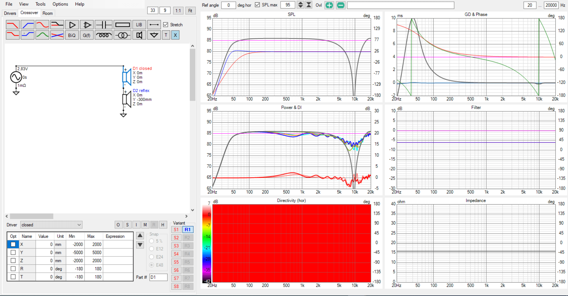

I'm designing floor-standing speakers. They contain two separated chambers as depicted on attached. The upper chamber is passive radiator system, and the lower chamber is sealed system. Note that the midrange labeled in the picture is actually a woofer in upper chamber -- No high-pass filter applied to it.
There is no problem with the lower chamber because it's simple sealed design. The problem is the upper chamber. I tried playing with online calculators, they suggested that the PR chamber is tuned at 33Hz, while the sealed chamber is tuned at 58Hz. If they're played the same music signal, will it cause any problems? However, it's similar to car audio system where the front and rear speakers may have different tuning frequency, I think.

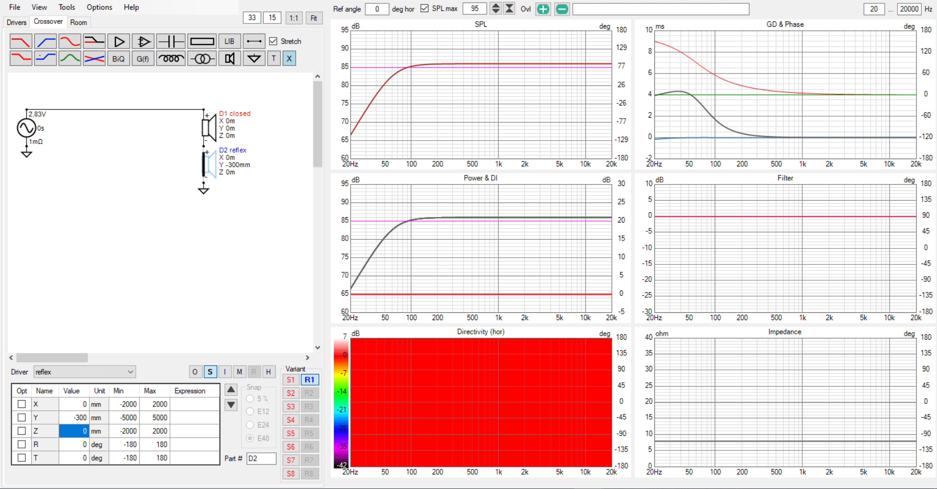

some driver in a closed enclosure

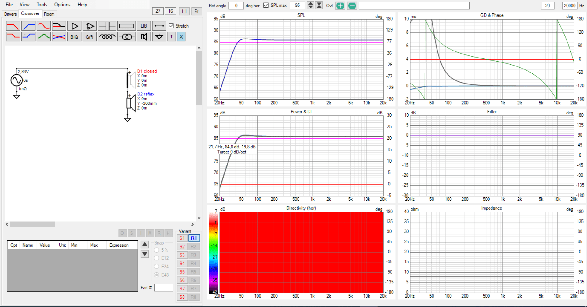

same driver in ported enclosure, which is equivalent to box with passive radiator

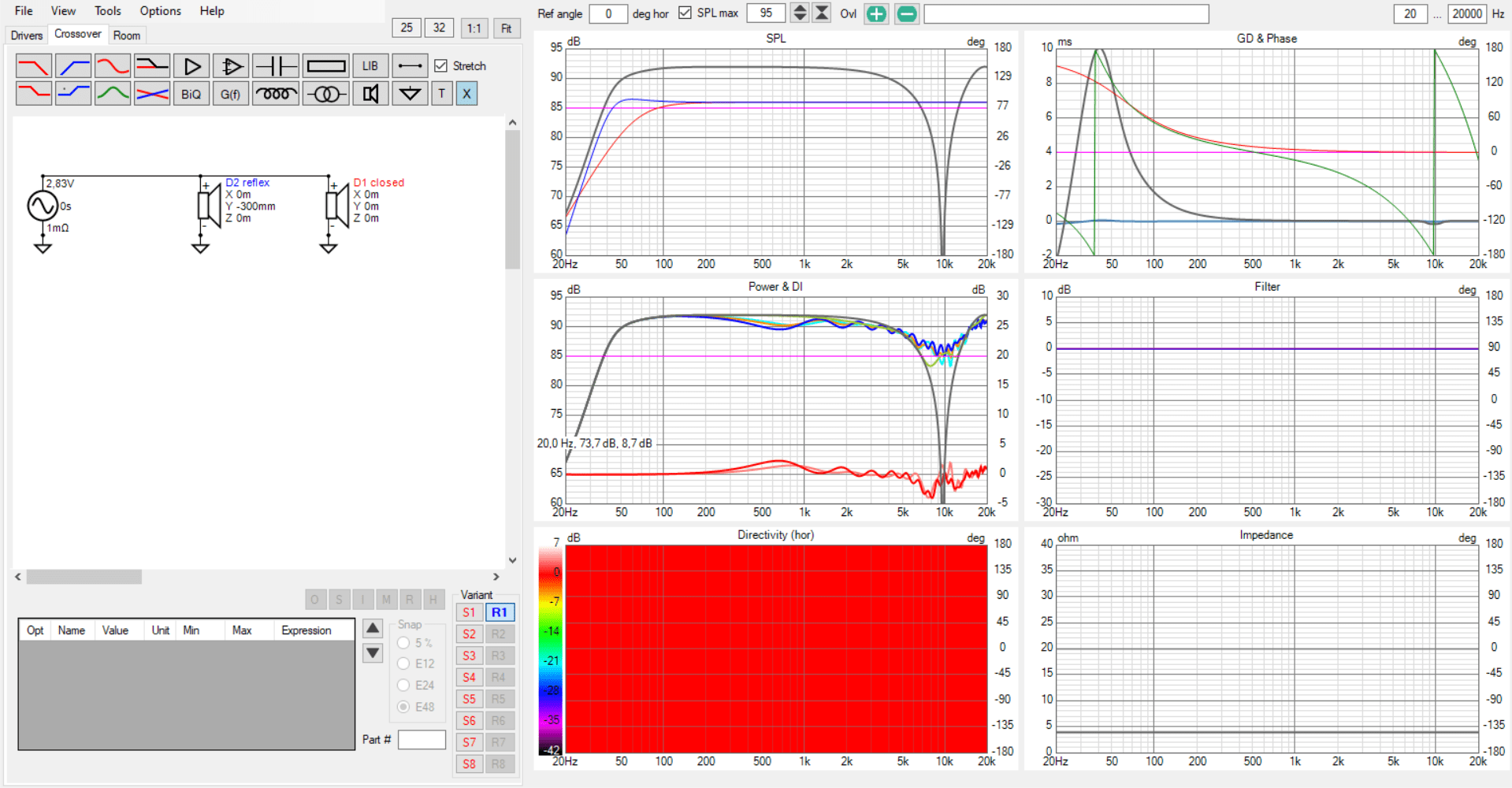

both in series and in parallel with 30cm c-c distance, one in ear level and other below.
The output at low frequencies is just mix of the two and doesn't seem to be a big deal in graphs. Perhaps for ear in room, no idea. I suspect not a big deal there either, because room dominates the response. Problems would be high in frequency, where path length difference of the two is significant in relation to wavelength. This holds true to any two sources whose bandwidth overlaps no just this kind of case. Note, these are simple ideal omni source results and the high frequency stuff with real drivers on a real box would look different.
There doesn't seem to be obvious downsides or benefits doing a mixed system like that, two equal drivers in two different kind of alignments. Perhaps with a long loud listening session heat accumulation would change the dynamics or something, not sure if it would be now better or worse. I would just build two closed or two reflexes, see no point having both, unless it sums into a high pass slope/Q that works better with room modes with intended listening setup, than either reflex or clsed. As you see the knee on all three is different. Rather than relying this to match the room I'd use DSP with either reflex or closed box system to be able to tune any slope/Q with any setup.

I see the passive radiator is for midrange driver, which seems odd. I would sell the passive radiator and make mid and bass sealed, three way system.
edit.
