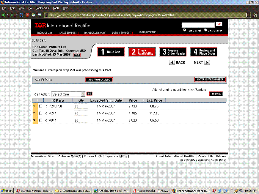

You can always order direct from International Rectifier, thats the easiest, buy a tube of 25 and chances are they'll be from the same batch, which usually yields better matches.
-john
edit: No stock of Irfp240 at IR, but plenty of the lead free pkg

Mega Amp John-
Nice tip about IRF--I wish I had known about that last week.....
