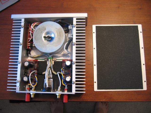

The Shaman said:
Is this per channel? The reason I ask is because I was under the impression that a 250VA 25V+25V was the minimum I could get away with in the stereo version(1 PSU, 2 Amp).
You can get away with 80VA per chip if they are not to be used full volume for extended periods.
125VA will power one(1) chip to full potential under most circumstances.
I used Apex.jr's http://www.apexjr.com/images/NewTorid.JPG x-former for a stereo amp consisting of BrianGT's premium LM3875 amp kit. I used it on my B&W 805's and a friends Madisound Thor kit. That is 100VA shared between 2 chips.
EVERYONE remarked how the little kit had better bass than his 300wpc Adcom GFA-8500(?).
The 25 volt toroid from Steve.
