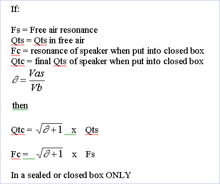

Here is the formula for the rise in Qts and Fs when a speaker is placed in a Closed Box. For a Closed Box with a volume equal to it's Vas, both Fs and Qts are raised by 1.4. This kind of box would be termed an Infinite Baffle. However, a Closed Box with a cubic volume much smaller than the driver's Vas would NOT be called an Infinite Baffle.
Please ignore the red and green lines. I couldn't get Microsoft Word to behave. 🙂
