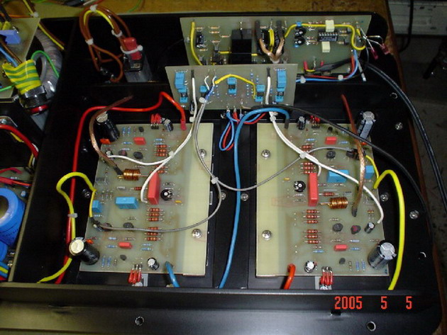

Jep, I made dozens of them. Never a problem. Lots of mods. and rock stable. The best amp. Elektor ever made. Made all the amps. from Elektor but this 1 stayed. Still use 4 of them.Very cool design
Wasn't it the original Crescendo that oscillated quite frequently ( or was that the other, later one ? ).
yes, jean-paul. It was the first Crescendo amp (1982) that oscillated pretty havely when used wired wound resistors. Mine amp runs perfectly since 1998.
With the Crescendo ME, I had first also a few problems wih oscillation, but these were solved by making better PCBs.
But I wouldn't know why many other amps couldn't drive these woofers, there are much better diy amps than the crescendo's.

the original crescendo schema:
http://www.audiofanatic.it/Schemi/Tipo/Stato_solido/finali/pic_finaliSS/70W_MOS_2SK135_2SJ50.jpg
