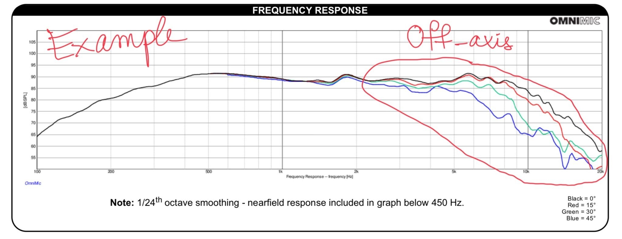

Well, nobody has replied the technical questions yet.
According to the attached example, which curve of the off-axis responses should be considered; 0, 15, 30, 45 deg, for selecting high-pass frequency for the tweeter, in case we’d use the natural roll-off of the woofer—no low-pass on the woofer?
The one that matches the dispersion of your Tweeter. At least if not distortion or decay demand a lower crossover frequency.

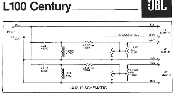

Actually, I was also inspired by the JBL L100 Century. I found they have only high-pass sections without any low-pass‘s at all as well.
The JBL L100 Century are not well designed speakers either. They have their fans but you notice very quickly how bad they are if you listen to classical music or hear them off-axis. Any speaker that can only play some kinds of music well aren't good speakers. And no, just because they have a big name on them doesn't make them any better.
