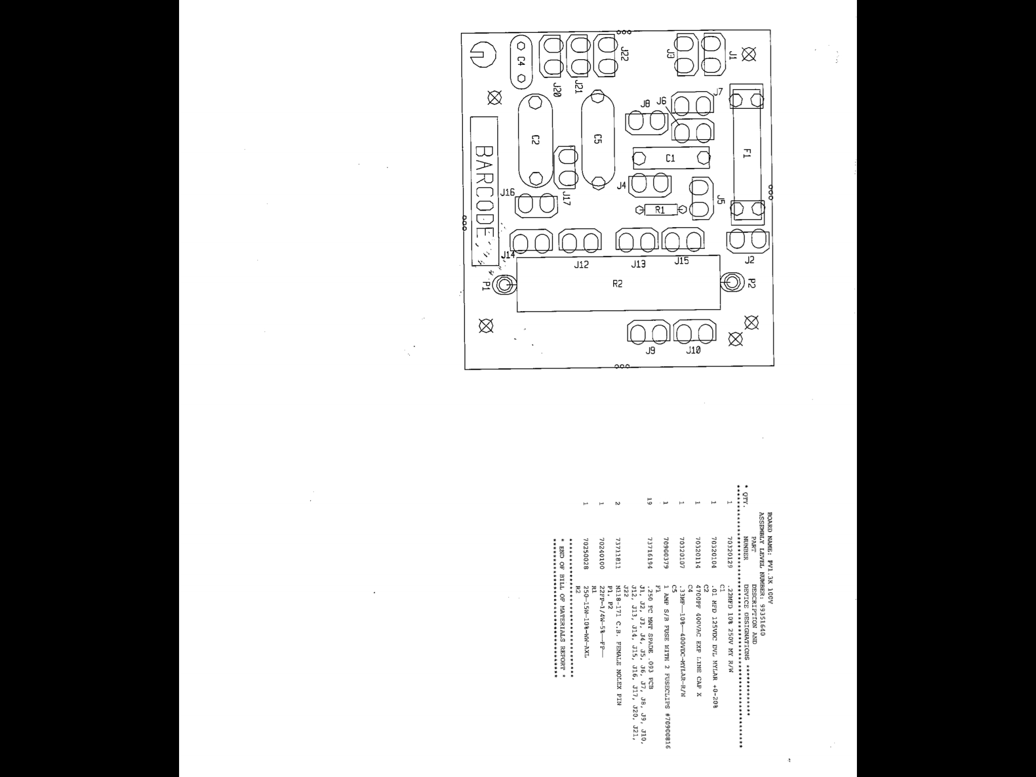

Recently I acquired a Peavey 1.3k power amp from my local church. Whenever I would turn it on,the cooling fan did not want to start spinning on it's own so I gave it a nudge and it would spin fine.Then I decided to replace the fan with a computer desktop 120mm fan,installed the desktop fan and turned on the power amp,fan started up just fine. Thirty minutes later,the fan stopped working and the power amp started to get really hot.I turned it off,opened the cover and found a blown resistor.
This it what the resistor would look like in it's normal state:
I turned on the power amp back on and it just makes a buzzing sound on left and right channels.
I'm guessing the mismatching voltage of the desktop computer fan made the resistor blow,i have no idea.
My question is,is it just a matter of replacing the resistor and installing the proper voltage cooling fan or did i kill the power amp?

You must find out first what actually this resistor is doing. If it is powering the fan then replace it and use a fan with the same voltage or You can even get a mains voltage fan.
As what the buzzing concerns, this amp needs some cleaning... Measure for DC on the output, if there is no DC probably it's fine.

I took the power amp to the local audio shop and they told me the resistor blew because i put a mismatching cooling fan in the power amp.
As for the amp itself ,it is fine,both channels fully function.
The buzzing sound was coming from a faulty speaker wire as i found out later after further inspection.

It is an 120 VAC fan. I think it says that on the label, whereas computer fans are usually 24 VDC. Also usually says that on the label.
The resistor is to slow the fan down for quiet when the amp is not hot. A thermostat shorts the resistors. Buzzing could be form interference from the open AC line running around the case.
You need to check the speaker connections for DC to make sure you have not blown the amp before connecting any speaker to it. About 100 mv max DC.

What he's saying is that the fan is powered by "the mains", AKA 120 volts AC.
In your post you replaced it with a 12 Volt DC fan - utterly wrong and dangerous to do.
In due respect, it's obvious that you don't understand basic electrical terminology, AC from DC, and the dangerous voltages involved.
So, in reality, you're embarking on dangerous territory, and my strong suggestion to you is to have that amp checked and serviced by a qualified service tech. - for your own well being.
The voltage and ac/dc numbers have to match. 120 vac could sub for 115 vac, but 12 versus 115 is way far off.

Amp has been thoroughly checked by qualified technician at my local audio repair shop.
Currently running at full blast with no problems using a 12 volt fan wired from a 12V mains power adapter. 😛
Ok, don´t come crying when it starts overheating and cutting off because of insuficcient cooling.
There is a reason Peavey chose a 3X more expensive AC fan instead of a cheesy DC powered one, but hey, maybe you know more than them 🙄

You chose a beefy DC fan, that´s to be commended, but still weaker than the original AC one 😀
Until I see datasheets showing both move same amount of air I´ll have to go by only parameter shown so far: motor power.
AC one shows 115V and either .26 or .21A so nominal 30VA or 24VA; while DC one is 12V and 1.4A for nominal 17W .
Again, that is a beefy 12V fan, hope it´s enough.

30 VA is not 30 watts - the power factor of a shaded pole motor is not just low, it is very low. Gets even worse if you lower the voltage (with the resistor, in low speed mode). AC fans often fail to start up when you do that, especially when there is the least little bit of resistance in the bearings. DC fans have the advantage of being more well behaved when slowed down at low voltage. Most of them do have awful bearing systems and wear out quickly, but good ones can be had. A good DC fan is more expensive than a good AC fan.
